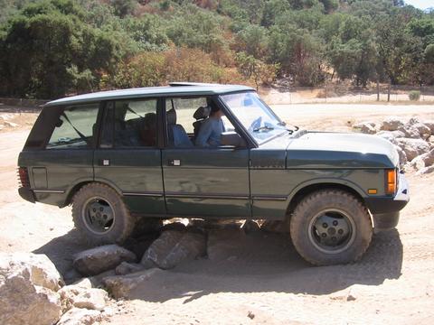

me? no more rub after a few turns on the steering stops with 245/75/16s with stock spings but it's a must to fold the fender trim in the rear well. I'm sure this is all N8tabasco needs to do and no more problemo. Thinking of putting some Super Swamper Thornbirds 31 X 11.00r 16 or 30 X 11.50r 16 has lots of clearance with the HD OME lift...
