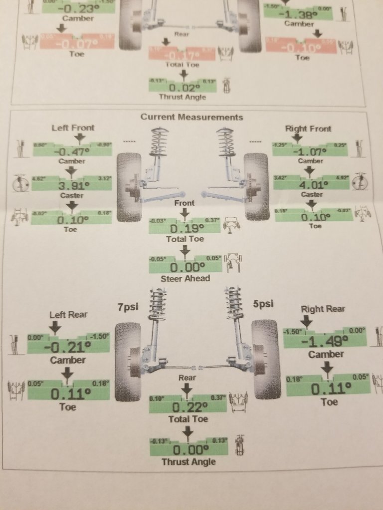

Here's the last alignment numbers I got. The problem is that our suspension is adjusting itself. As soon as you turn it off it drops an inch, and messes with your alignment.
If you have the GAP iidtool, just put the body control for the suspension in tight tolerances at the alignment shop. And don't forget to turn it off right after.

Any harm in getting LR3/4 alignment done at a local tire shop vs the stealerships?
In the Mercedes world (where I'm more proficient), taking your MB to a generic alignment shop almost guarantees the alignment won't be done properly. Mercedes requires a few uncommon procedures that are different from the norm for setting toe, and usually only the dealer will do it properly. Indy alignment shops that do a lot (like, a hundred per year or more) with a tech that knows MB's very well can do the alignment no problem, but those types of indy shops are rare.
Anyway - it kinda sounds like there may be a similar situation with the LR air suspension. The dealer should always do it properly, but not as cheap. Unless the indy shop knows how to set the suspension in "tight tolerance" mode, AND has the GAP IID tool to enable this mode, I get the impression we are gambling the cost of a set of tires if we have the alignment done elsewhere.
I haven't owned our LR4 long enough to need an alignment yet; so far the tires are wearing evenly. When the time comes I'll just go to the dealer. Hopefully they aren't more than the ~$150 or so the MB dealer charges nowadays.

Getting an alignment done today. Is the "tight tolerances mode" in the service menu of the GAP tool?
1,858
I assume you are getting the alignment done somewhere besides the dealership?
Yes. I bought a lifetime alignment from my local Firestone a few years ago for $150, and have gotten 3 or 4 alignments since then. They've all been pretty good, even though I never thought to put it in tight tolerances mode until this time.
