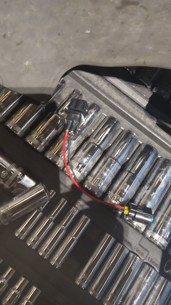

I am in the middle of this job. For those of you who upgrade your intercooler pump I have the info to create your own harness instead of splicing in. I will also share some info for doing the valve cover gaskets.
Mercedes parts
230-540-00-81 Coupling x1
008-545-63-26 Plug x2
000-545-68-80 Rubber Ring x2
Bosch plug
