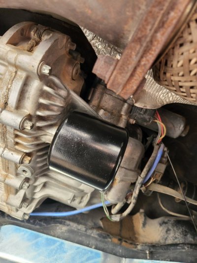

I've been stalking these part numbers on/off for years, they've been out of stock everywhere or I couldn't find it. I finally go a hold of it on Rimmer Bros and installed it. I seriously tapped out the hole since 2019. 20220810_172957.jpg

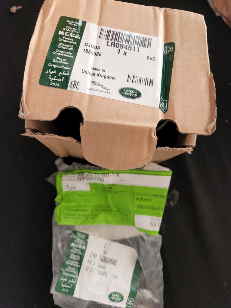

This thread helped me out a lot, thanks to everyone who posted. Adding info that might help someone else.
TECHNICAL BULLETIN LTB00305NAS3
Vibration damper IAI500100 / LR094511
Purchased the parts from Scuderia: https://www.scuderiacarparts.com/part/1092676/landrover/lr094511/damper-vibration.html
My 2013 LR4 did not have the hole in the transfer case threaded. Bolt & Nut Supply in SLC verified that the IYP 50080 bolt needed a M10 x 1.50 tap. Tapped that hole using a vice grips and WD-40, torqued the bolt to 55 lbft, and the damper eliminated around 90% of the vibration around 2500-3000 rpm. The LR4 drives so much better now.
Picture of the correct tap for this bolt is attached. This was the first time I'd ever used a screw tap, it was easy, and worked perfectly.
