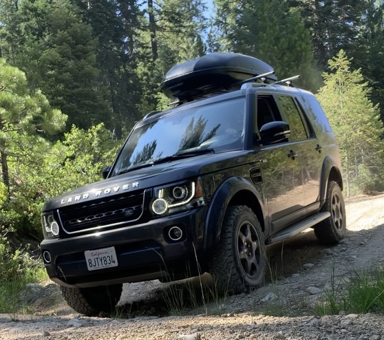

I wouldn’t be worried about a little rubbing when full lock and in access mode (how often do you need full lock in access mode? You’ve got bigger problems if you’re stuck in access mode.). But my understanding is that the 265/65 - depending on the particular tire - can rub a bit when full lock even when not in access mode. Not that a little rubbing is such a big deal either.
I went with 265/60/18 KO2’s mainly because I wanted the option of keeping a fully inflated spare underneath, and the size seems to fill out the wells good enough. 265/65 might look slightly better, and gives you another 0.5 of sidewall if I recall. Here’s a pic if you’re curious (though there are probably a million pics of this combination)
adclark
Apr 26, 2021
19
Southern California
@jlglr4 that looks good! seems filled out enough, thank you for posting a pic. are your compos black or anthracite?
I may just pull the trigger on black and not wait 6 weeks for gray... seems like 265/60 or 65's work based on preference. decisions... @ryanjl what does E-rated mean?
