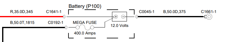

Not sure how difficult it is to remove the starter and simply test it when it's out but that's what I would do; I'd be looking to ensure that it's:
1) Turning
2) Has enough grunt to push the pinion gear in to the flywheel
The answer to these two questions may help figure out if you need a replacement or it's an electrical issue? There's also a starter relay:
And the huge fuse (as you mention):
I don't know where the fuse is but this implies it's somewhere between the battery +ve and the starter motor; FYI - the black cable depicted above goes directly to the starter motor.
