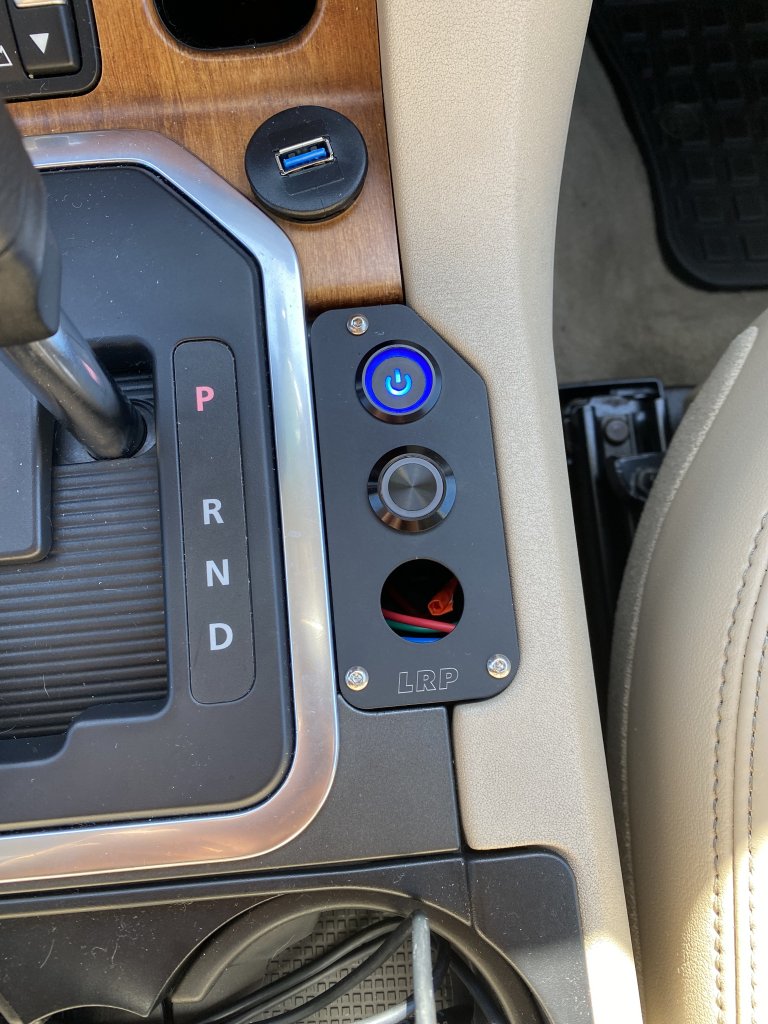

I had a similar problem. On the NaviPlus receptacle, I spliced the RED +12V wire and hooked it up to a latching switch with a LRP Bracket. So I have direct control on the power draw by the NaviPlus unit. The other switch is a dummy switch for cosmetics.

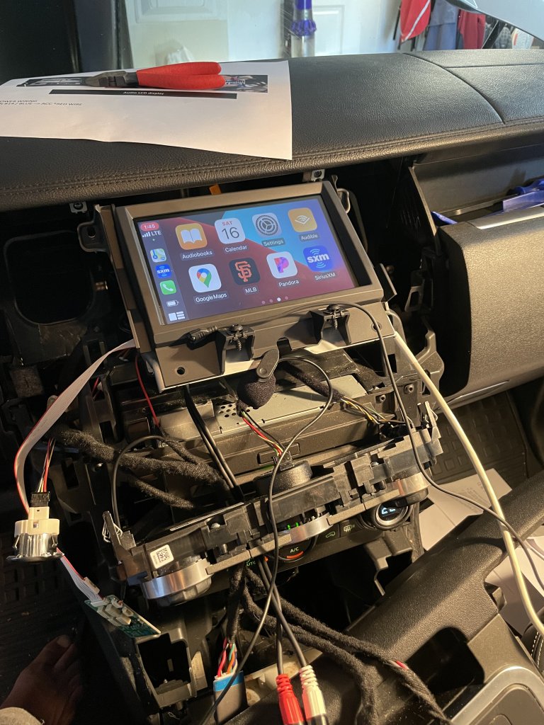

I just finished installing the NaviPlus (Australia) CarPlay system in my 2011 LR4 and it works GREAT, with one exception. The component that provides the wireless connectivity is always on and runs the battery down.

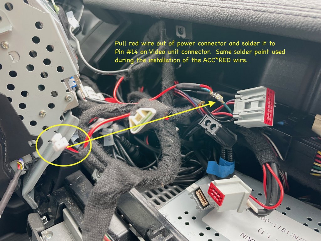

I just finished installing the NaviPlus (Australia) CarPlay system in my 2011 LR4 and it works GREAT, with one exception. The component that provides the wireless connectivity is always on and runs the battery down. Documentation is not great, but NaviPlus support was excellent with my few installation questions. They just showed me how to re-wire the power connection into the AUX feed so they unit will fully shutdown when the doors are locked. Looks like a simple wire cut/splice with minimal soldering.
I would say the installation was hard, 7 out of 10, and not for the faint of heart as you have tear apart the entire console and solder a wire (or two) and then figure out how to place all the components and 2 circuit boards back into a small space. But well worth it!
View attachment 21210View attachment 21211
This should *hopefully* allow the NaviPlus system to fully power off when the doors are locked...
Quick update. I just finished reconnecting the power lead to the ACC connection on the Video unit connector and it solved the "always powered on" issue. WiFi/Bluetooth NaviPlus/Carplay signals go off when the doors are locked.
