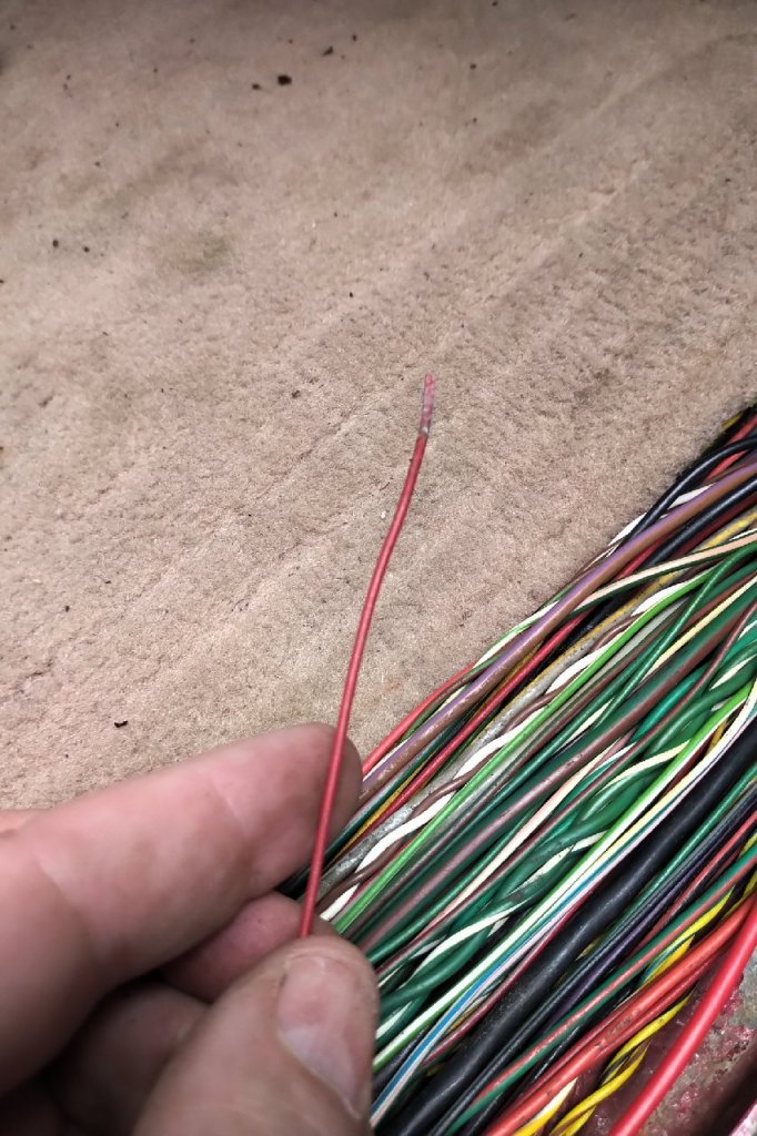

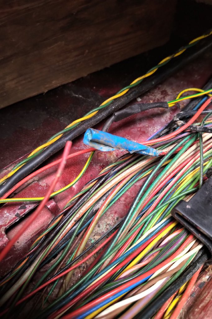

Found on another forum where someone was adamant to look for a red corroded wire. They were right. I couldn't see the actual connection, I just gently tugged red wires and it came right our. Used a heat shrink butt wire connector. Problem is fixed. The photo of the blue tape shows the leftover corroded wiring.

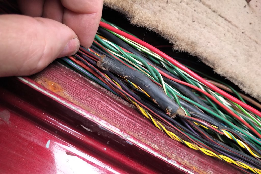

That looks like a added extra that’s been added by a previous owner.
I don't think it is. The previous owner didn't seem like someone to add things to the vehicle. And according to LR, she did all of her repairs and service at LR. After hunting it down I think it relates to seat belt wiring. I think.
