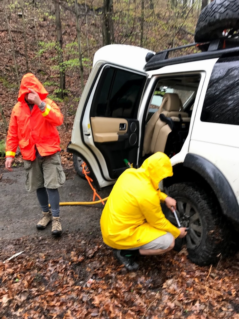

The duratracs will end up casting you more! After 10, I give up on them. Almost every trip I lose 1 or even 2 new tires to a sidewall cut. Cant air them down <30psi with out increasing the risking too greatly. Im probably moving to BFG KM3, since most of my miles are just adventure trips at this point. I am tired of being the only one changing tires every trip:
