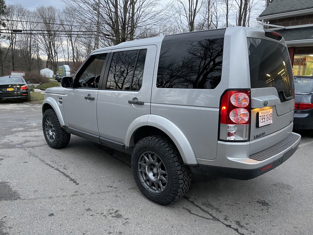

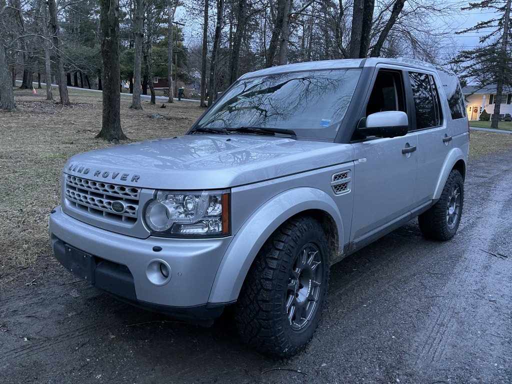

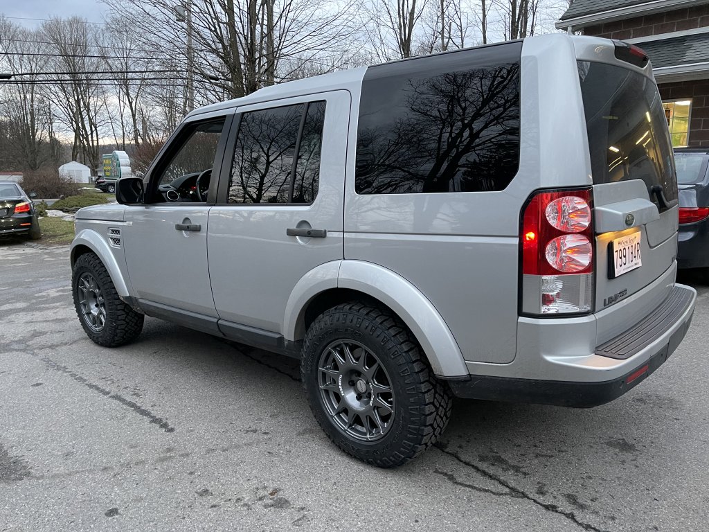

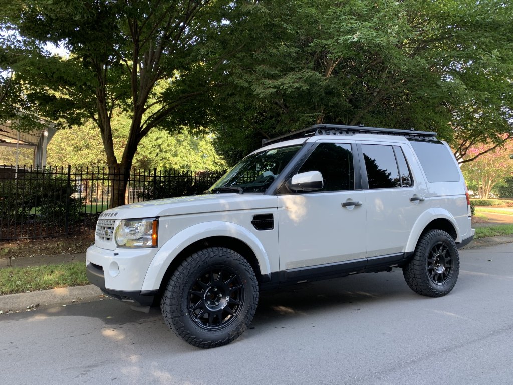

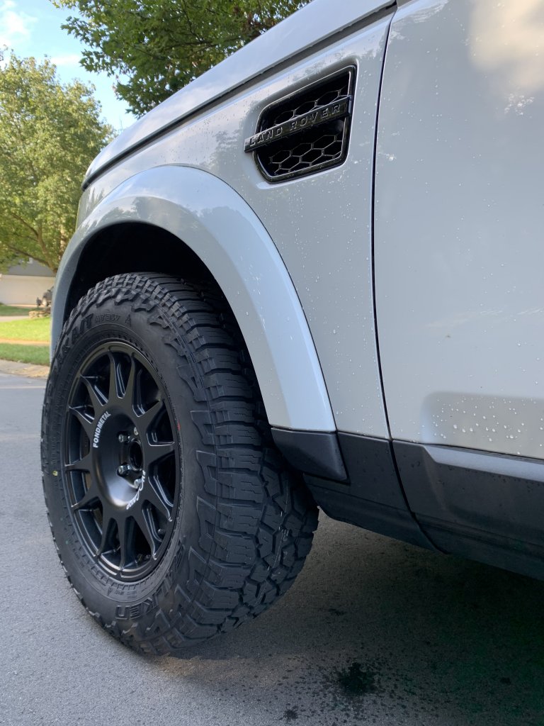

Just had a set installed today, tires are Goodyear Wrangler Duratrac 265/65 18. Stock height. Ever so slight rub on full lock on frame horns. Not enough for me to start cutting away. So far I’ve only driven on the highway and the tires retain that comfortable ride. Maybe even more so with the added side wall. Pictures are at stock height and off road height

These look to be an amazing alternative even to the stock LR 18s for LR3. Do others have experience off road and is there any rubbing/clearances issues due to the offsets? I believe stock 18”s are 53mm and these are 35mm. Evo’s would be outward an additional 18mm and the Evo’s are 8.5” width vs stock at 8”. Looking at some of the pics tires look about even with the fenders, whereas the stock wheels are tucked in a little. I understand tire size makes a difference too, looking at 275/65/18. Would love to get more input on these from those that have run them for a while. Thanks!

Interested in knowing this as well. Also @Eric N, wheels/tires look great! How is the performance so far? Do you have center caps installed in yours? looks to be in the pics but not 100% sure.

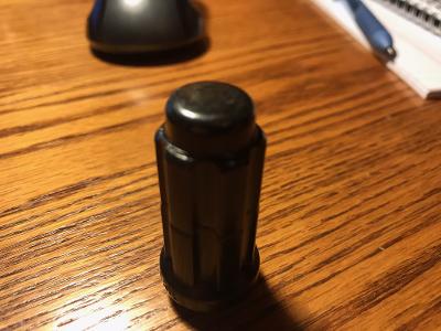

I recently purchased a set of these for my LR3 and had a question :
What lug nuts are you guys running? Mainline Overland sent me a set of long splined lugs that I don't like the looks of (too long) and the don't have as much thread bite as the stock lugs, so I'm not sure if I have the correct ones or not. I have attached a pic of what I have. Looking at the other pictures of wheels on this thread, the lugs look nothing like the ones that I have.
Help would be appreciated since I certainly don't want to risk losing a wheel.
