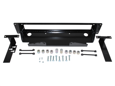

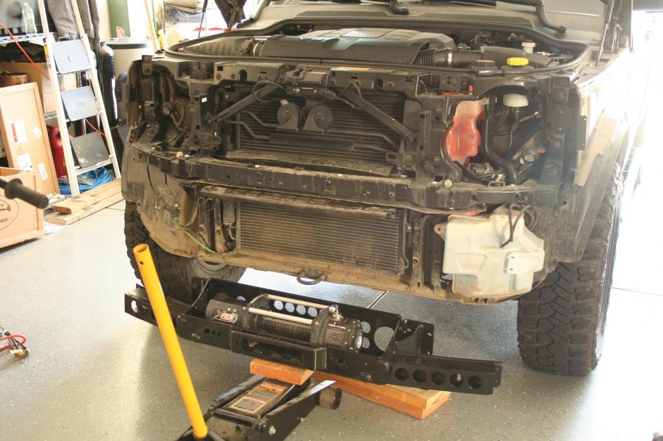

I'm confused, did you order one from Devon or Britpart/Terrafirma? They are different designs.
The Devon has a wider cross section to replace the steel inner bumper. the Terra/Britpart version is just a winch tray. Pics below. The Terra/Britpart version is less than ideal as you have to remove the steel bumper and have nothing in the kit that extends in front of the wheels in replacement.
And the reasons I ask all this is because I wanted the Devon version, but ended up with the Terrafirma version because Devon stopped importing. If I can get the Devon version shipped, I will jump all over it...
