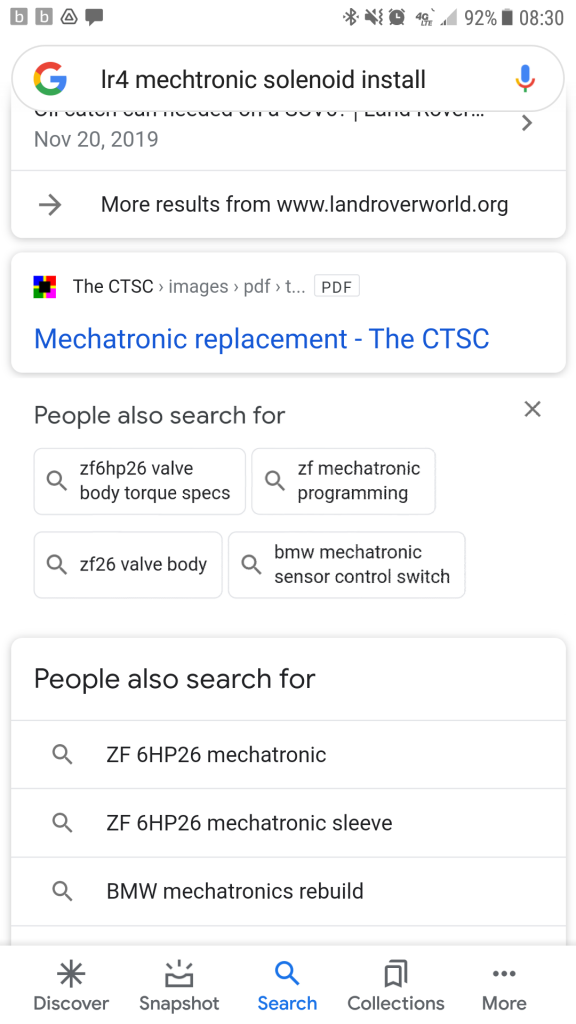

I see there is a mechatronic solenoid replacement kit for the lr4.
is this something that could help my 2-3 shift issue?
i also now know of the upgraded trans pan gasket, which i regret not using when replacing my pan/filter (paper gasket is seeping)
im thinking that if the solenoids could help, ill change to the better gasket and hopefully knock these problems out at once.
and...can anyone provide a link to a DIY for solenoid replacement?

I found these. The pdf link may help best, but I cannot upload the pdf here.
https://landroverforums.com/forum/lr3-28/transmission-rebuild-87764/
