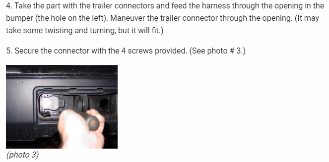

My husband bought the Trailer Wiring Kit from Atlantic British for our 2011 LR4. He is having a really hard time with this step (see below pic) to get the connector in place to line up the 4 screw holes. He has twisted and turned as the instructions suggest but to no avail. In the picture below, the 4 pin connector appears to be on the bottom, but the part we received, the connector is on the left edge and perhaps we got the wrong part? Anyone have trouble with this part and any suggestions?
Here is the picture of the part we received with the 4 pins on the left edge:

Ours was a little annoying to install. I would recommend dropping the spare tire to get more room to work.
I remember that we had to rotate the connector to figure out the best way to fit it. I think I installed it so that the four pin connector is on the right and closer to the tow hook. You can also try it with the four pin on the left and see if that fits better.
We also had to move the rubber grommets by removing and reinstalling the electrical tape. This created a better routing solution.
Hope that helps.

@Michael Gain Thank you so much for the response. He did drop the spare tire and with lots of futzing, finally got the piece in place with the 4 pins on the left. However, the screws just won't hold. I crawled underneath with a flashlight while he is turning the screws and I'm able to see 3 of the 4 screws are in place and turning. But no matter how much he turns, the piece just won't hold. I can't see the fourth screw with the angle I was at, so I'm not sure if that last screw was lined up or not. He's at the point where he's not sure he's stripped the screws out now, after trying for so long. Did you have issues with the screws?

Hardest part was rotating the connector around in every direction to get it through the hole in the bumper.
I did strip out the head on one of the screws. Pretty sure I ended up replacing 2 of the screws with better quality stainless steel screws.

After lots more futzing, he finally got it installed, but with the pins on the right side instead of the left. It really shouldn't be this hard... he was working on it all day yesterday and then this morning.

@waltzonice glad he got it installed! The screws are so fine threaded that it does feel like you are screwing them in forever.

This was my install experience to a tee, on both of my LR4s. Except in my case I had the reverse of the OP's situation with loose screws. For me, the screws to mount the connector were incredibly tight. I also had the issue with the grommet not placed correctly. I made it work as-is because I didn't want to undo that tape job. However I did remove a bit of tape to free up more of the grounding wire from the loom.
