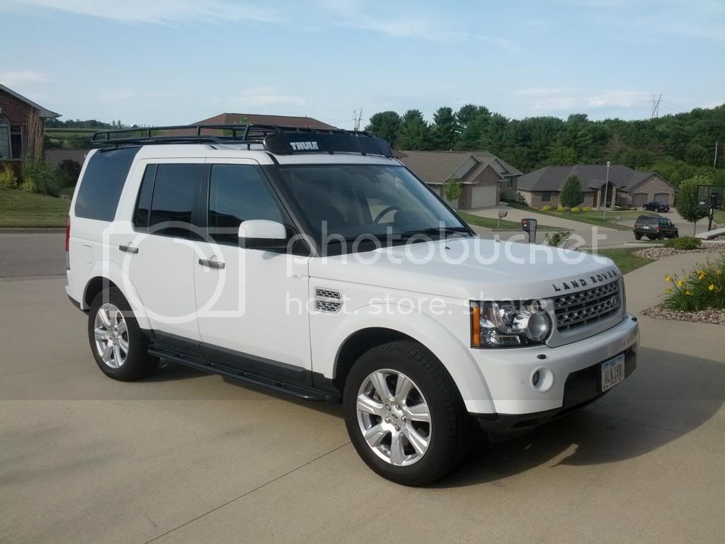

Hope he doesnt mind me reposting, but this is Bushway's pic from the showoff thread.
OK, EDIT... he basically answered my question in http://www.landroverworld.org/forums/showpost.php?p=138454&postcount=29
Johnson Rods at normal ride height. 265/65/18 tires.

I just responded to your question in the LR3 section. Let me know if you have any further questions. I have a 2010, so it is actually Alaska white, which is more of an off-white. I like the white walls, and it certainly draws a lot more attention that this rig is set up for off-road as opposed to Starbucks (not knocking Starbucks, because I seem to end up there quite often as well). Either way, regular or white wall, you can't go wrong. Also, I don't think the rods would look inappropriate if you didn't have your bigger wheels on. Even on stock wheels, I think the rods make the LR4 look a lot better. As for your spare, I didn't realize you had a roof rack. Definitely throw it up there. If I had one, that's where mine would be.

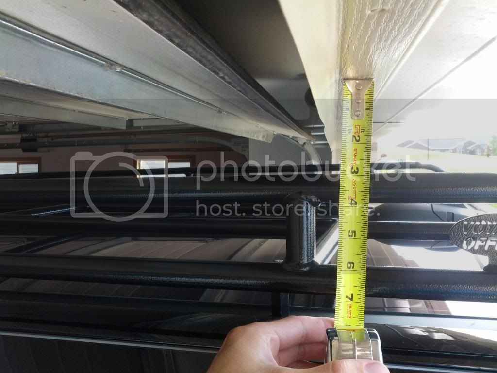

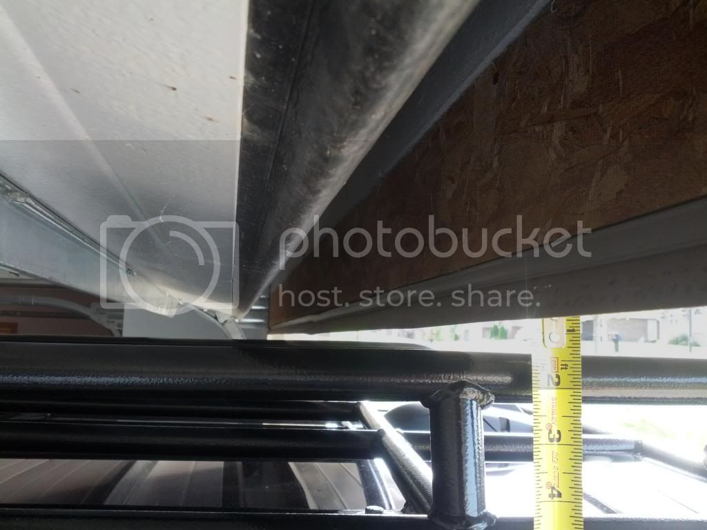

Here is my main issue I guess.
Stock Suspension and tires, Normal Height:
Stock Suspension and tires, off road height:
Here is the car as it is today:
1,694
So, I need to calculate the exact height add that the larger tires on 18" wheels adds, plus the .. what 2"? that the rods add.
Wow that looks great! Yes the rods are 2". With the 265/65R18 and rods, you can drop it into access height and pull straight into the garage. As long as you aren't turning with it in access height, you'll be fine.

So my rough math.
255/55/19 Stock tires height= 30.04 (calculated and measured on my car, very close)
265/65/18 height=31.56
so adds to body height of .76" if I go that tire size.
So, +2" for the rods (is it really exactly 2")
= 2.76"... giving me what? .24" of clearance at normal height?
