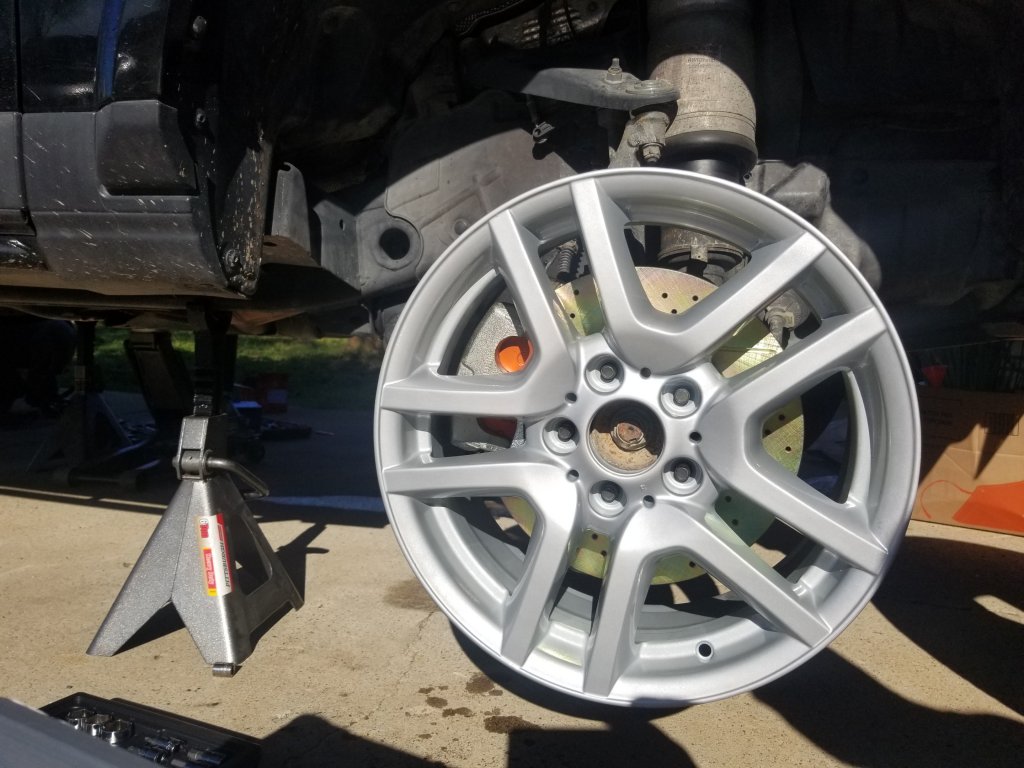

I believe, although I haven't done it myself yet, that it is not necessary to swap the calipers to get to a 17" wheel.
The rear can be left alone and will fit 17s, but the front will need new rotor brackets, rotor, and calipers to fit 17s. At this point you'll also want to get extended wheel studs.
Also, make sure you're 17s are hub centric with the 5x120 bolt pattern. Luckily, the BMW X5s fit almost perfectly. This is where the extended wheel studs come in.

Have you done it on yours? Just wondering if you are speaking from first-hand knowledge?
Yes, I've done did it.
Did you just press extended studs into the existing front hubs? Source for the extended studs?
Ok, not proud of this and may get some backlash on this, but I'm using 10.9 grade 50mm extended wheel studs from ebay. I've only pressed the fronts in. I haven't had time to do the rears, which requires me to remove the entire rear hub to press out/in the wheel studs. And at that point, I was thinking about doing the wheel bearings too. I can give you more details over PM. At this point in time, I don't want to be criticized for running anything except for oem. :laugh:
If you did change the front calipers, am I correct in assuming you used an LR3 caliper?
Technically it's the same LR3s and LR4s caliper that you'd find in the 2.7L diesel. Oops, I said too much.
The rear uses the same oem stock caliper. You can get away with the rear stock setup leaving a 3mm gap. Not much, but it'll work. Swapping the rear gave something like a 7mm gap.
Again, if you have questions, PM me.

Here's the rear clearance with the mod and you can see how shallow the threads on the studs are. I can get about 7 full turns on it. Not ideal...

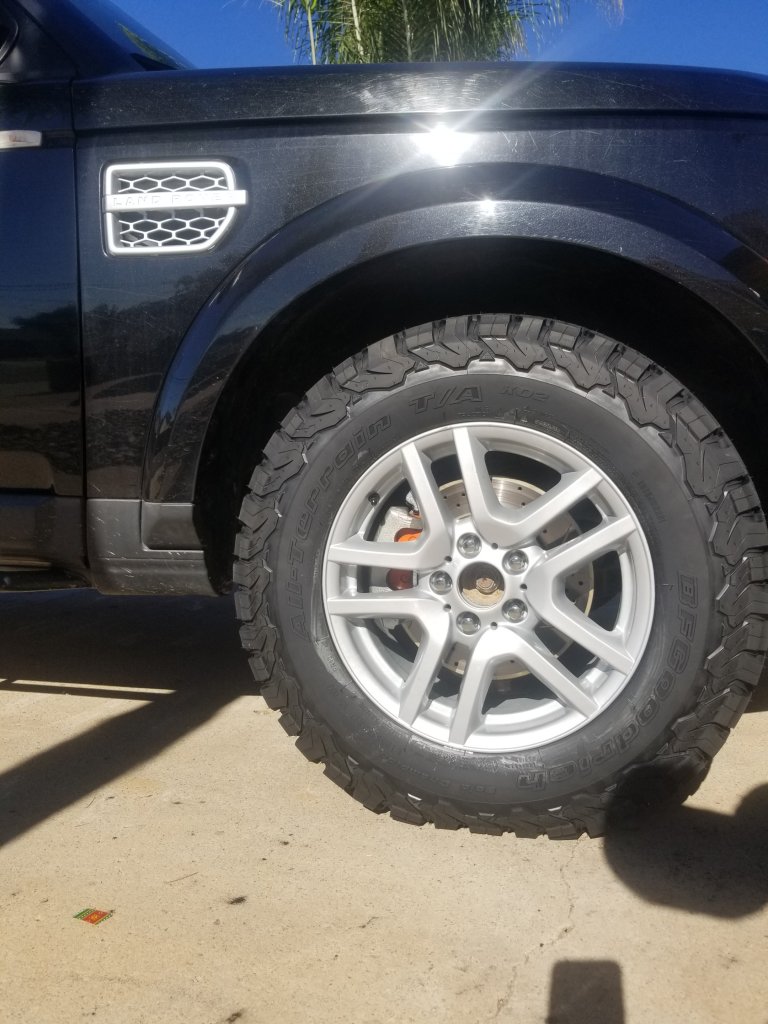

This is the front setup with tires.

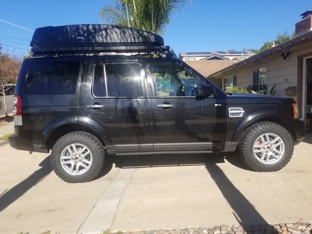

This is the new setup... I got all 6 of the same X5 wheels running 255/70r17 BFG KO2s for under $2k. Yeah, I was being cheap on the tires since they were on sale. Otherwise, I would have gone to 33s or something.
