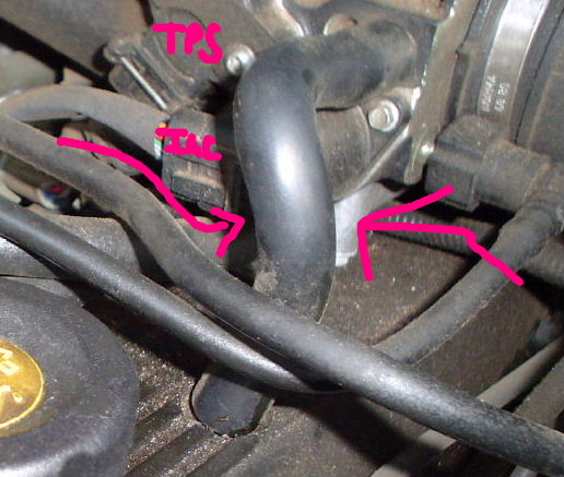

ok so where do you do it on a disco 1
I would like to do this on my disco 1 and have read about it a few times but on the manifold where would you put it in.??

Look at your throttle body and intake manifold, find a vaccumn line that is easy to get to that has good vaccumn and that is the spot.
Buy 2 or 3 feet of line hook it up and stick the other end into the bottle of SeaFoam or what ever you are using. Regulate the flow into the engine so it is slow and takes up to 5 minutes, I do that by squeezing the tube with a pair of needle nose plyers. When your done turn off the engine for 30 minutes and then go drive.
thanks
Erich
This is where u add SeaFoam. Good Luck.
