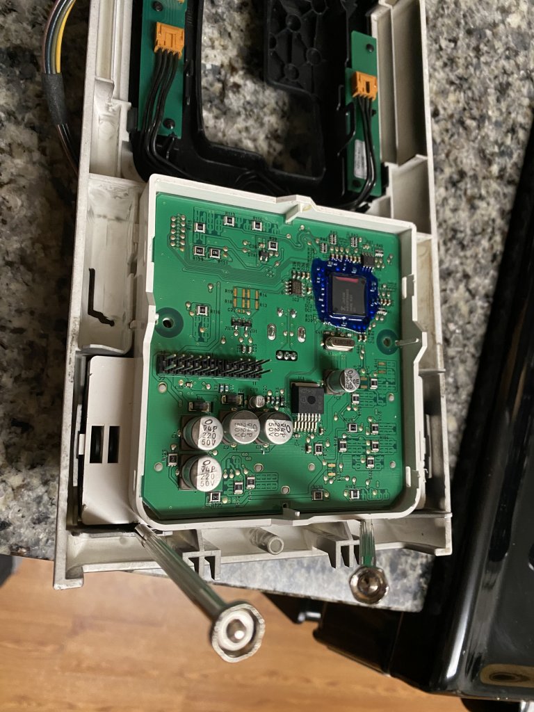

Dthomp, how did you get the switch apart. I have it out of the console, I am past the locking tabs that holds the circuit board assembly in the surround, but I can’t get the white assembly to pull free of the surround. Any help will be greatly appreciated.

Hey, I just did this today to fix my high/low range switch. I diagnosed the issue with my obd2 scanner in "live data" for the switch position.
It was difficult as they are really stuck on there but you have to pull the terrain response selector, both paddle switches and the hill descent switch off the front to access the other side of the circuit board. then you can clean the contacts under the rubber boots.
