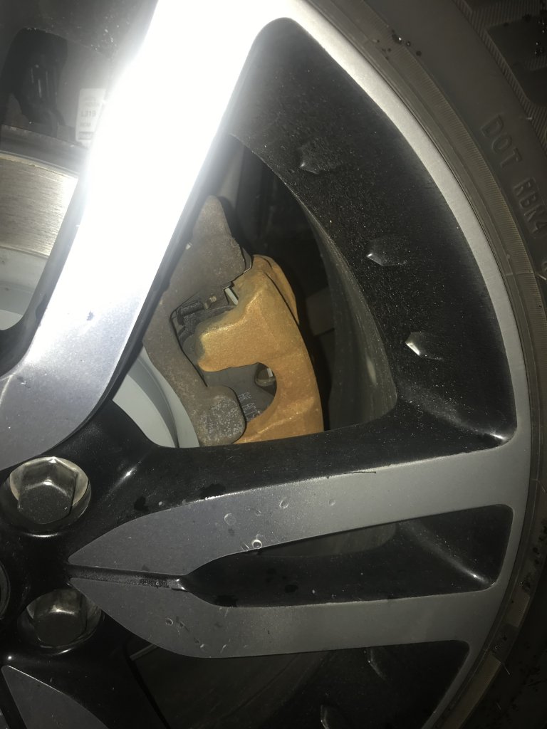

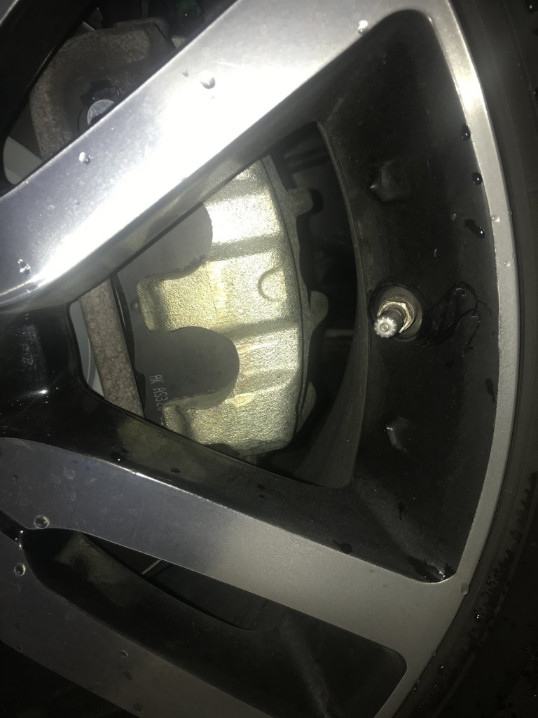

I recently got new brakes, rotors, and calipers at my local indy shop. The calipers were covered under warranty because they 3/4 seized. Now, after about 6 months, 2 out of the 4 are bronzish color, almost look rusted. See pics below - one normal and one bronze. The bad ones are front R and rear L. Any thoughts? Thanks!

agree. cheaper steel, bad coating, corrosion. hopefully it stays as cosmetic corrosion, but if it gets into the seal area, they may have a shorter life than OEM (or higher quality aftermarket)
you could go through the work to remove and paint them.

cant hurt to ask the shop. you could also pull a wheel off and look for a sign of part numbers.
when looking over those photos again, the first photo is definitely surface rust. the second photo looks to be gold toned, mostly likely the caliper finish.
