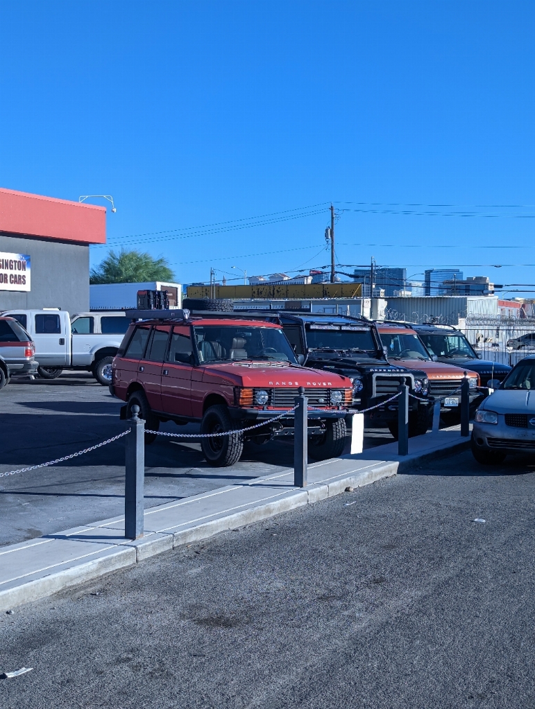

I did a drive-by and at least they have Land Rovers out front. The last place I was looking at for the chains didn't have any on the lot yet their web page was clearly Land Rover specific.
