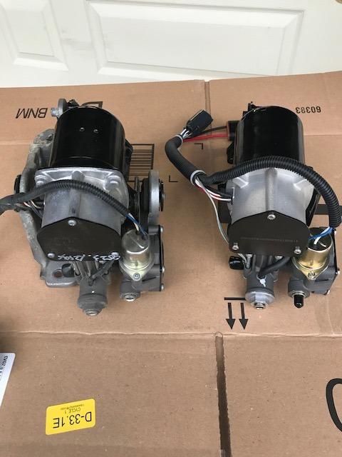

Ok, so I replaced the compressor and that corrected the issue I was having. it worked great for a couple of weeks. Then,,, the red suspension fault light comes on. Dropped to the bump stops. Not driving anymore for now. Ideas, why the red fault light? Does it define where to look for the issue? Any and all help is appreciated. TIA

Hmmm...did you put in an AMK or Hitachi? If AMK, did you replace the relay and do the software update?
