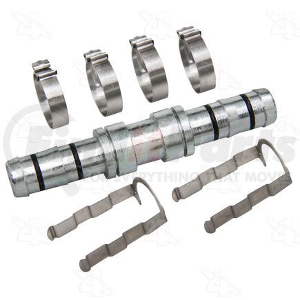

Is it the rubber hose or aluminum?
Rubber hose, you can cut a section out and splice in a metal tube.
