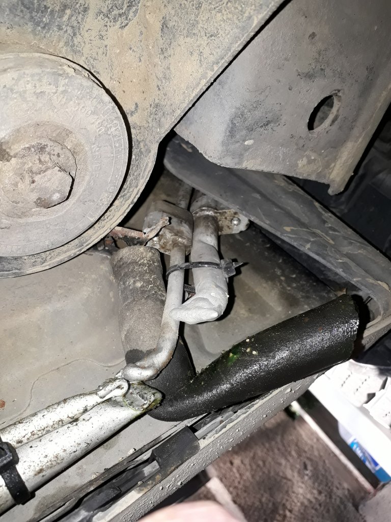

Does anyone have experience with blocking rear air conditioning lines in order to have working/cool front air conditioning? Looking for instruction and/or video on how to do this. Thanks.

Yes. We cut the lines under the driver's seat and soldered the ends of the pipes coming from the engine bay. Recharged and it's good. All the front vents and the two blowing back from the center console are ice cold. Back system still blows room temp air. Heater is unaffected throughout. I wish I'd done it earlier since I wasted several cans of refrigerant with the leak. Good luck.

Sorry for the delayed response. I'll snap some pics and post tomorrow. You will be underwhelmed. We cut the pipes and closed them off. Not connected to one another. Super simple but it's worked for me.

Although I appreciate the ingenuity of the poster that cut the lines/recharged--the time/money invested in that fix could've been spent on having i fixed correctly.
I guess if you don't care about resell value, having the rear vents blow cold, and having your system hacked on--go for it.

By the way--I'm not judging the poster that cut/welded--just helping the OP think through an "easy" fix vs. doing it "right"
