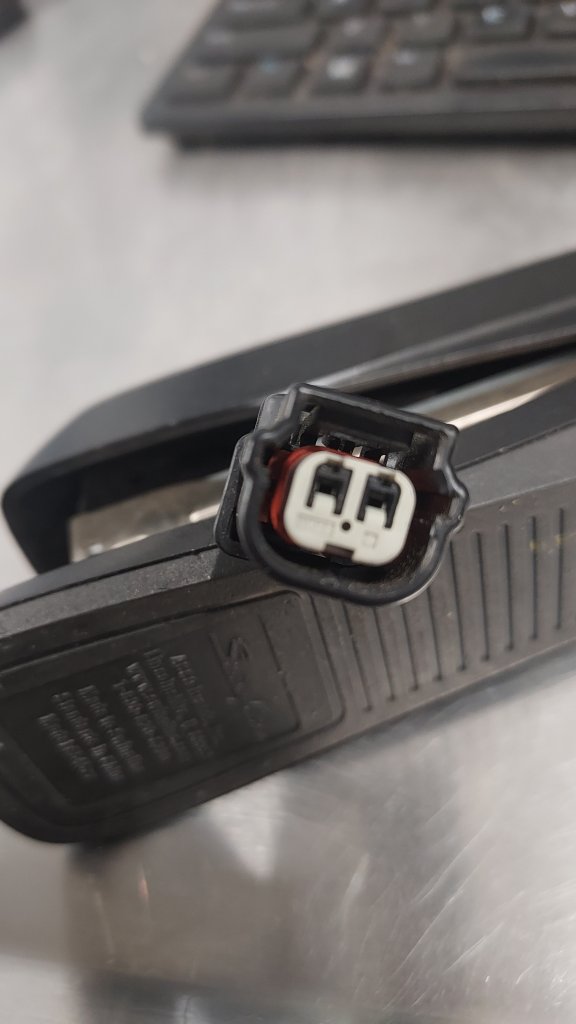

@CO-LR4 - any chance you still have that old variable timing solenoid plug connector lying around your shop and would be willing to sell it?
I came to the forum searching for my P0010-13 code (Intake (A) camshaft position actuator - circuit open) and was about to order a new solenoid + updated electrical connector following your path... but a quick visual inspection first revealed that a rodent has chewed straight through the wire right at the plug connector. Open circuit, for sure. Seems everyone only sells the updated connector these days.
We have some used harnesses here.
I found the connector you need. Just pay shipping and it's yours.

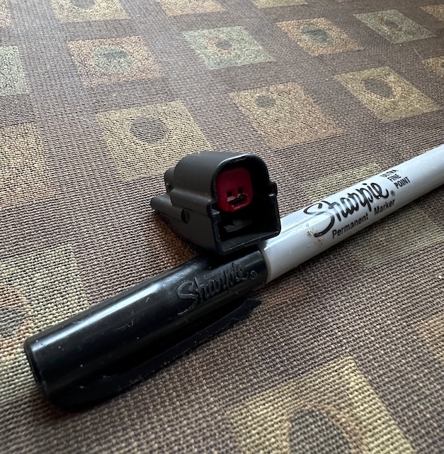

Oh bummer, mine looks like the photo below. Could yours be the updated 12x14mm connector? Mine measures more like 16x19mm and looks like this...
