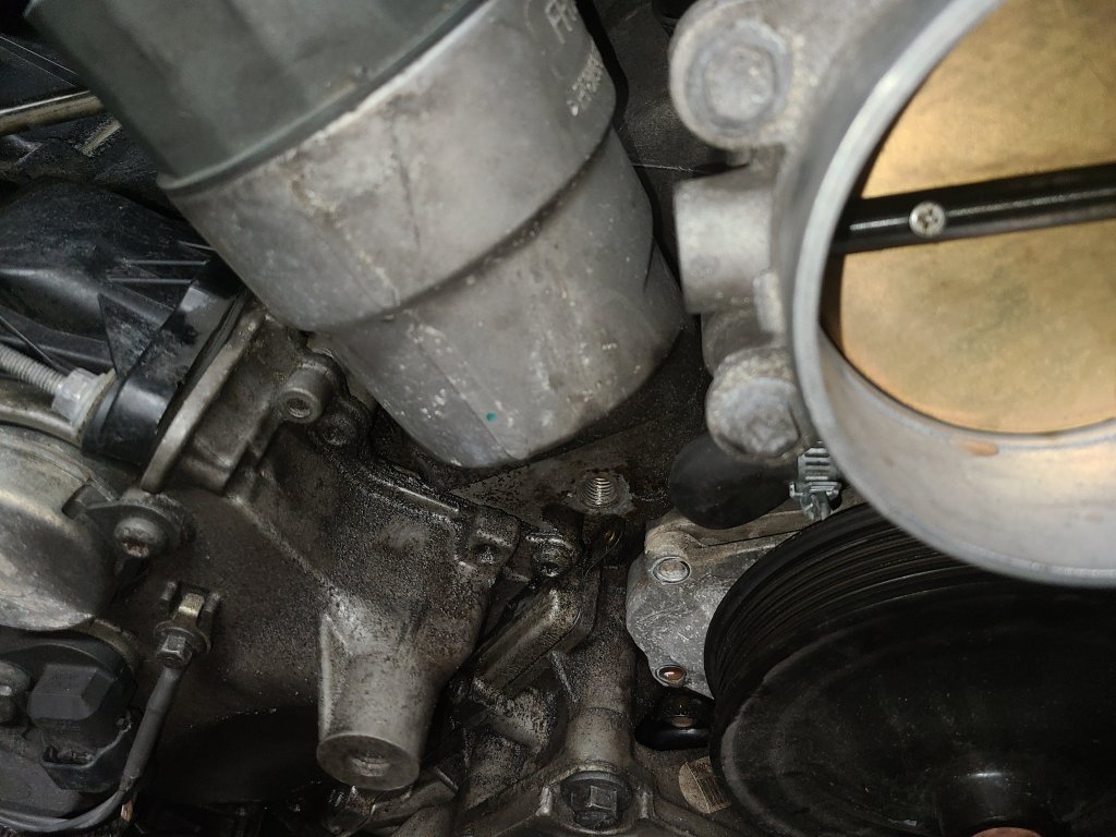

Just replaced the oil filter housing gasket. This repair should take someone about 20minutes.
I couldn't find the torque specs, so I went with 9ft lbs....same as the water pump bolts. Figured this was a good spec since its the same type of metal pressed gasket. If anyone can provide the correct tour spec, that would be great.
Did it while replacing the water pump (preventative maitnance).
When I was in there I noticed the filter housing attaches lower than the valve cover gasket. There was no oil coming from the higher area of the valve cover gasket. Which reinforced the filter housing gasket was the issue.
I'll update in week or so.
EDIT: confirming 9ft Lbs was correct torque value. all torque values in post 18
Davidinseattle
Dec 18, 2015
398
148
seems my 2011 LR4 has classic land rover issues.
This time i noticed oil on the front on the engine, dripping all the way down onto the alternator, power steering rack and frame rail. this is a new leak. only shown signs of a leak since after i changed the oil about 1 month ago.
i know i did not spill a single drop and the housing is not cracked. I changed the oil with a slightly, maybe too thin of oil (0w20) for my high mileage (140k) car. i have since swapped out the oil for Valvoline 5w20 high mileage oil. i did not remove the filter when i swapped the oil, so there is no chance of spillage in the area.
maybe the too thin of oil has created a leak? maybe it will fix itself now?...doubtful.
anyway, without disassembly, the furthest i can trace it to is the top of the engine. the crevice between the passenger side valve cover and the intake manifold has minor oil residue down the length of the block, but there was a small pool of oil in the same crevice right next to/behind the oil filter housing base. is the oil filter housing gasket known to leak? i kind of hope so as its a rather simple fix.
Ive read that sometimes valve cover gaskets leak, but since the leak was concentrated directly next to the filter housing, im hoping for the easier solution. Also, the valve cover gasket was replaced by the previous owner (at land rover dealer), albeit about 80k miles ago.
any advice is welcome. thanks in advance.
