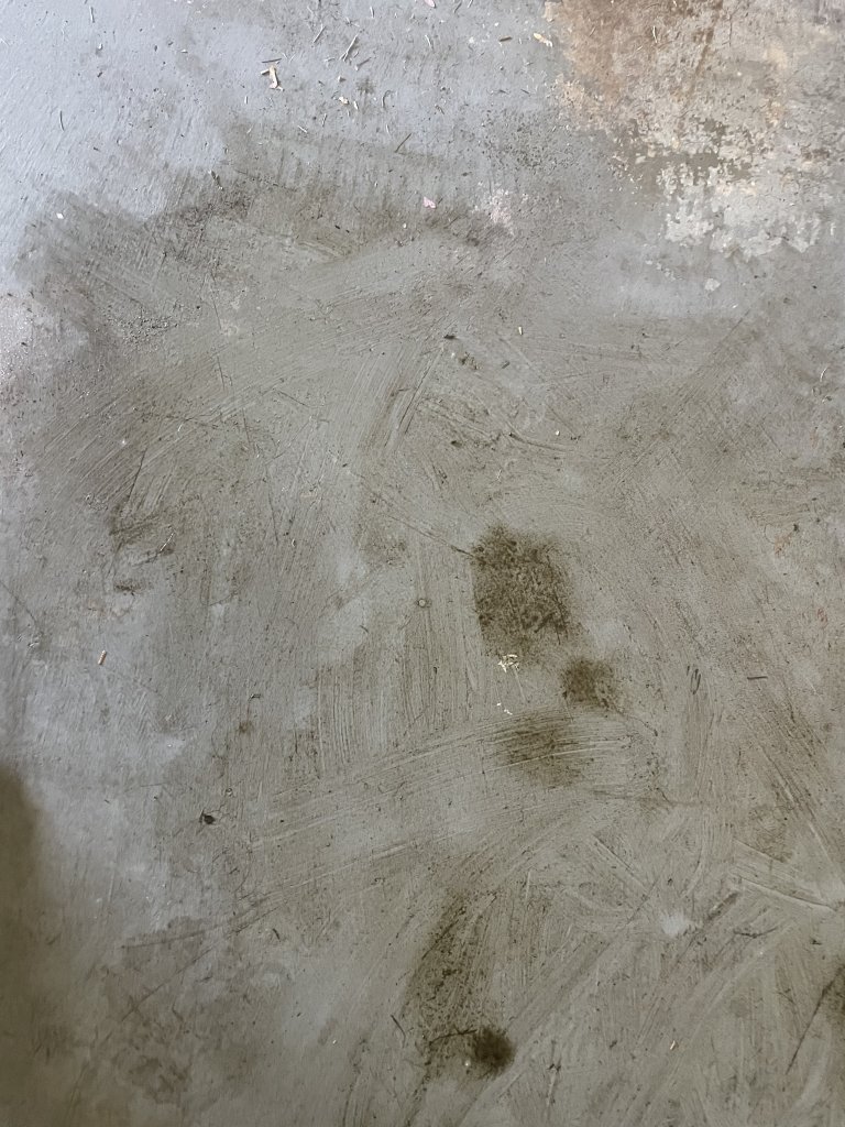

Pls see photo. Curious to hear what you think this very small leak is. Location right under the engine block. Oil levels (coolant) and engine oil seem okay and I am keeping a close eye.
Would appreciate advice on how to narrow this down and potential correction, if any.

If stock it could be your LCA hydro bushings giving up the ghost. They are oil filled. Need to get on the ground and get some pics. Feel around with your hands, it's the Land Rover Experience. :)

Like a ****** mystery. All we see is what‘s left on the garage floor.
If you need help identifying the fluid itself, you’ll have to let us know what it feels like and smells like, i.e., oily or watery, sweet smelling, burnt smelling, etc. Also, looks like it could have mixed with residue on the floor, making ID even more difficult. You might try putting a clean non-absorbent pan of some kind in that spot so you can collect some fluid for ID.
