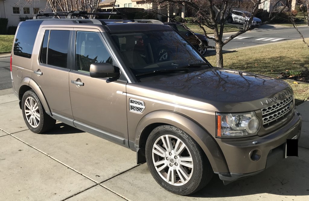

Our 2010 LR4 HSE has reached the end of our journey together. On Sunday, at 245k miles, she finally skipped time due to loose chains (they had started making noise about 20k ago so I knew what was coming).
So my question is, what to do with her? Copart will give me $2,200 and tow it away, which seems like a good deal. I don't have the space to keep her around to part her out. Perhaps there is someone out there on Craigslist interested in rebuilding her? If you're in Northern CA and are interested, let me know.

Oooo! I notice you've got the Continental TerrainContacts. How have you liked them? I want them so bad for mine, but the previous owners put a brand set of the 4x4 Contact (OEM tire) just before I bought it so there's tons of life left in those. I'm not swimming in cash enough to just throw perfectly good tires out.
I have indeed enjoyed the Conti TerrainContact ATs in mixed driving; mostly paved around town and long road trips but also some fun offroad outings that involved gravel/loose surface, water crossings, mud, mild snow, and beach driving. They aren't the most aggressive *looking* tire but they definitely have more presence than a straight street tire. For my needs they've been just about perfect. I wish the lug profile was a little more pronounced around the shoulder purely for looks, to be honest. But it's a cool tire. If I change them out once the tread is beat, I'd only move to something else because I like variety. I could also easily put another set of these on and be very happy.
