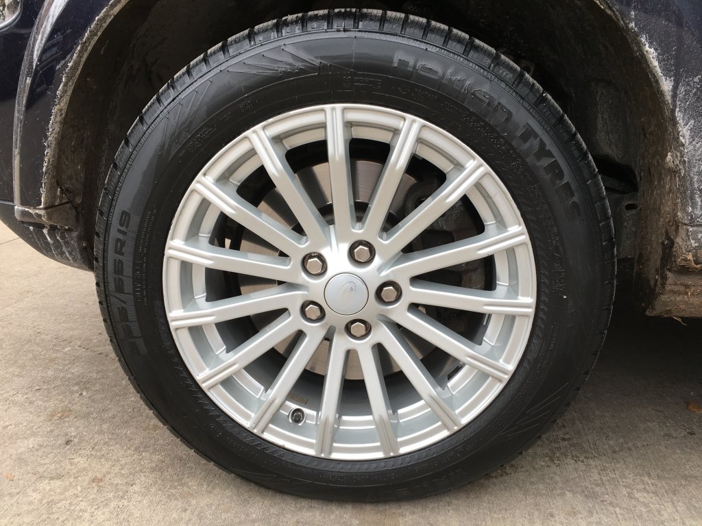

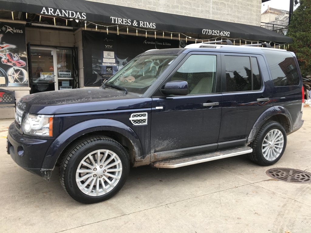

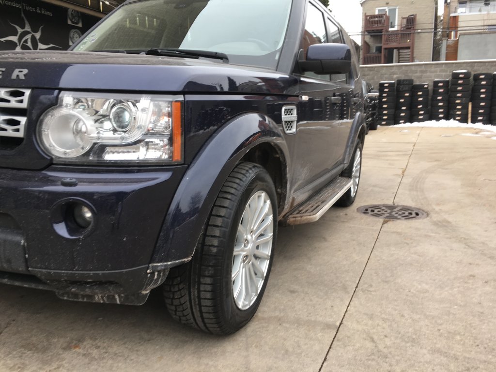

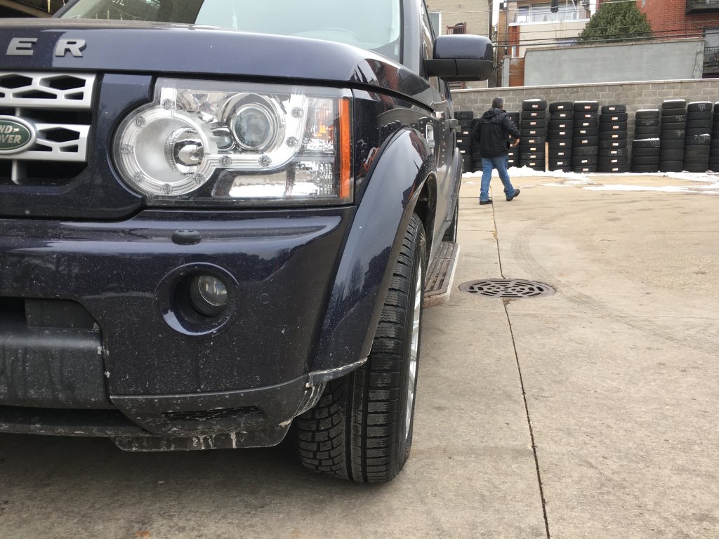

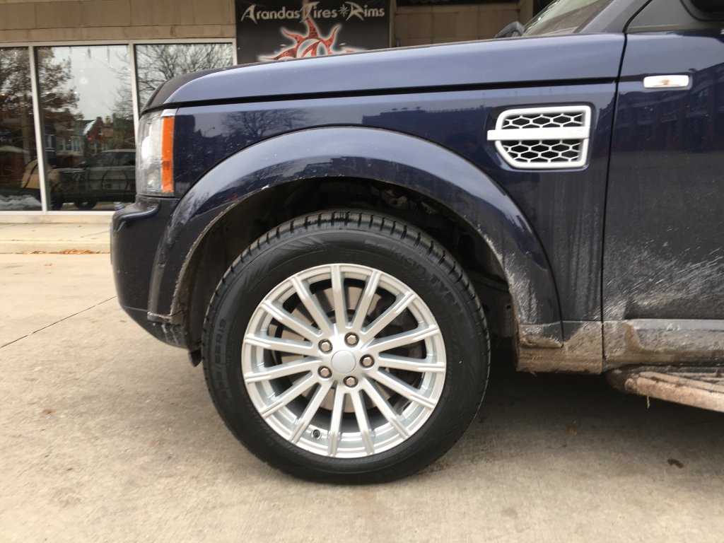

Just installed the Nokian WRG4 SUV 255-55/19 on a set of 2010 Range Rover Sport wheels. They fit great, look great, and so far drive great. Full review to come
