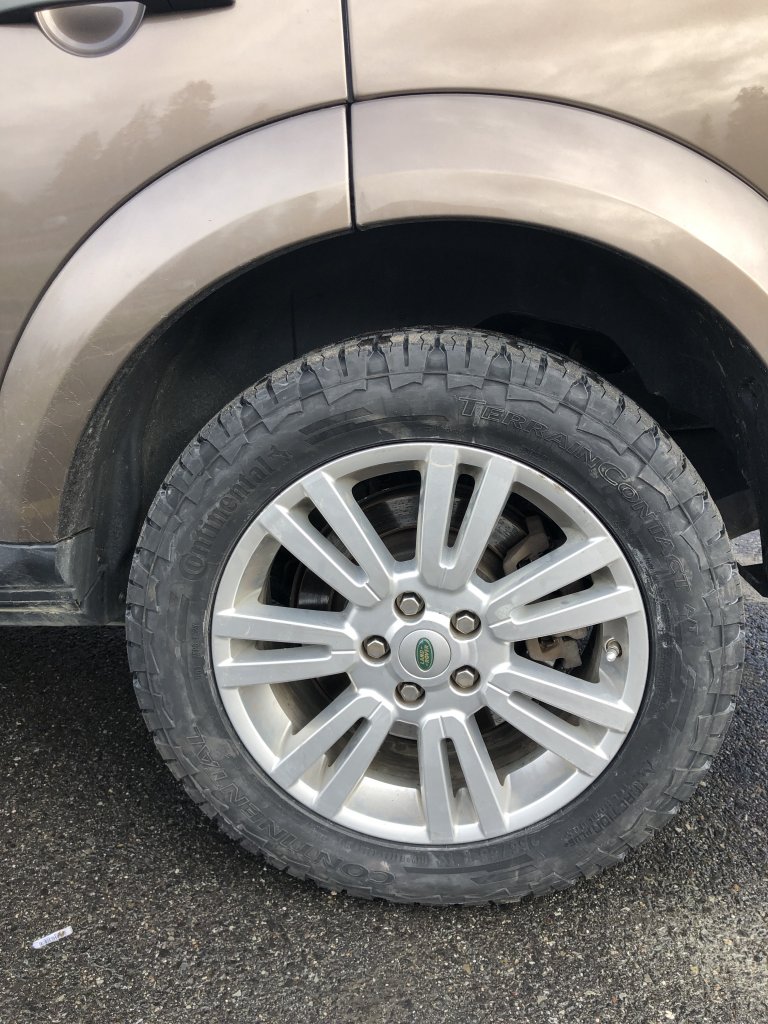

I just installed last Friday the Continental Terraincontact AT... They look great and I hope they live up to their great reputation.
I had the Duratrac's and they got progressively louder as they aged. Hope this helps.

I'm coming up on one year running these Contis and I have no complaints. Great in around-town and long haul road driving. I have had them on the trails in easy to moderately difficult situations. I did cut one sidewall in a fluke incident in muddy offroad conditions, but I happily ordered a replacement when I got home. The TerrainContact A/T is a solid all-around 19" option for the LR4 for those who don't have specialty offroad needs.
