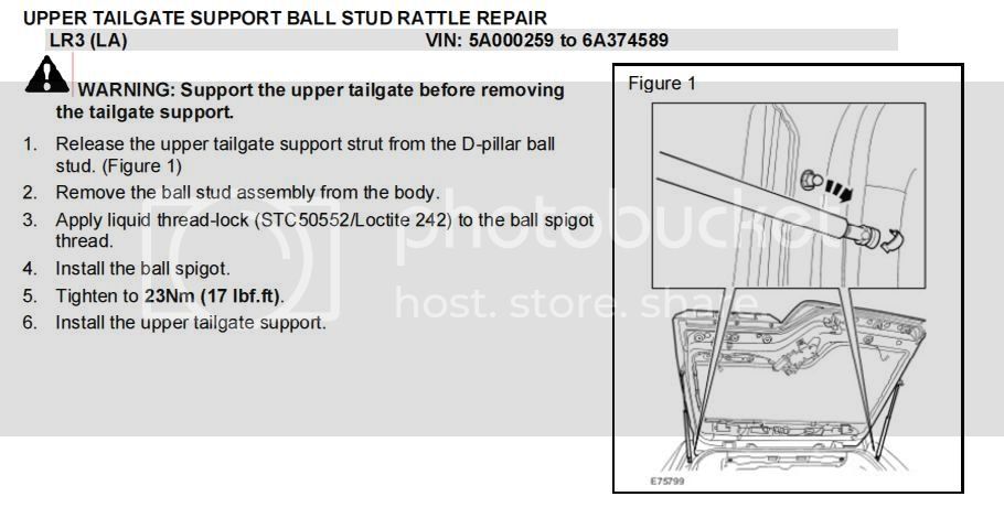

Yes, this is a common issue, and agree that it can be a safety issue too and LR could be handling it differently.
There is a pivot bolt in the d-pillar where the rear hatch struts attach. It has threads, and screws into the d-pillar. This bolt can back out over time, causing the right side strut to become disconnected.
I had this happen post-warranty about 6 months ago. The pivot bolt was damaged as a result. I was able to replace it (for under $2.00) and it took less than 5 minutes to repair. Not sure why your dealer charged so much, unless the nut got stripped (the part inside the d-pillar) which could be difficult to replace, or perhaps the strut got damaged.
It would be a good idea to inspect and tighten these on a regular basis as a precaution.

I have no idea what you are describing. Any photos?
Here ya go...
nwoods
Apr 27, 2006
1,675
24
Yeah, I got it the second time around. I was thinking the origional poster was describing the B pillar area initially, but then realized he meant the rear lift-gate. Good diagram! Certainly a well documented issue, as this 14 page thread demonstrates: http://www.disco3.co.uk/forum/topic3721.html
