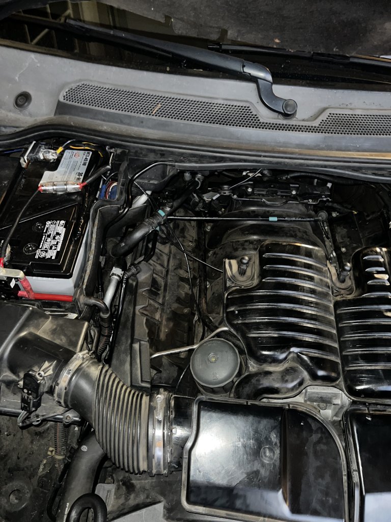

Also here is an over view. I’ll take the intake duct off if you guys are Interested in seeing the whole set up

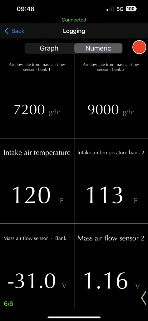

Just a note, the MAF sensors ground direct to the ECM (separate ground pins for each sensor) I know this isn’t too helpful, just a small detail to keep in mind while troubleshooting.

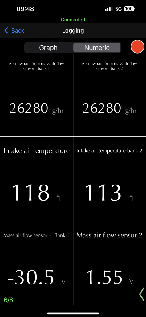

Here is my set up. I have ran a cable directly from the negative terminal on the battery to both coil grounds. If I shouldn’t be running the car like this let me know. Also I believe the car thinks the battery is low however there is no sign of lack of battery power. Every time it starts it sounds healthy. I did get that code for the MAFs and I figured out why. Although they are functioning properly the voltage is completely out of range.

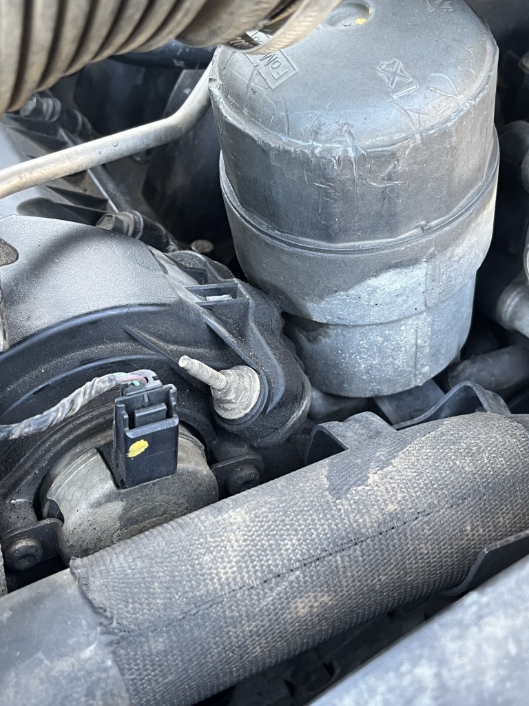

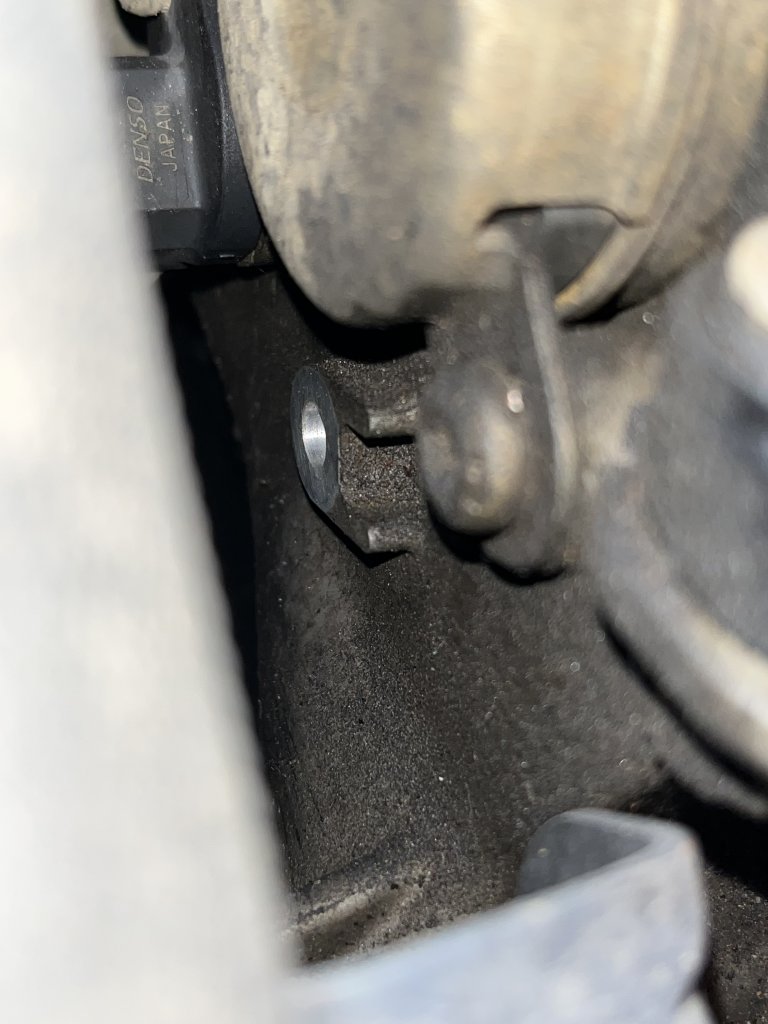

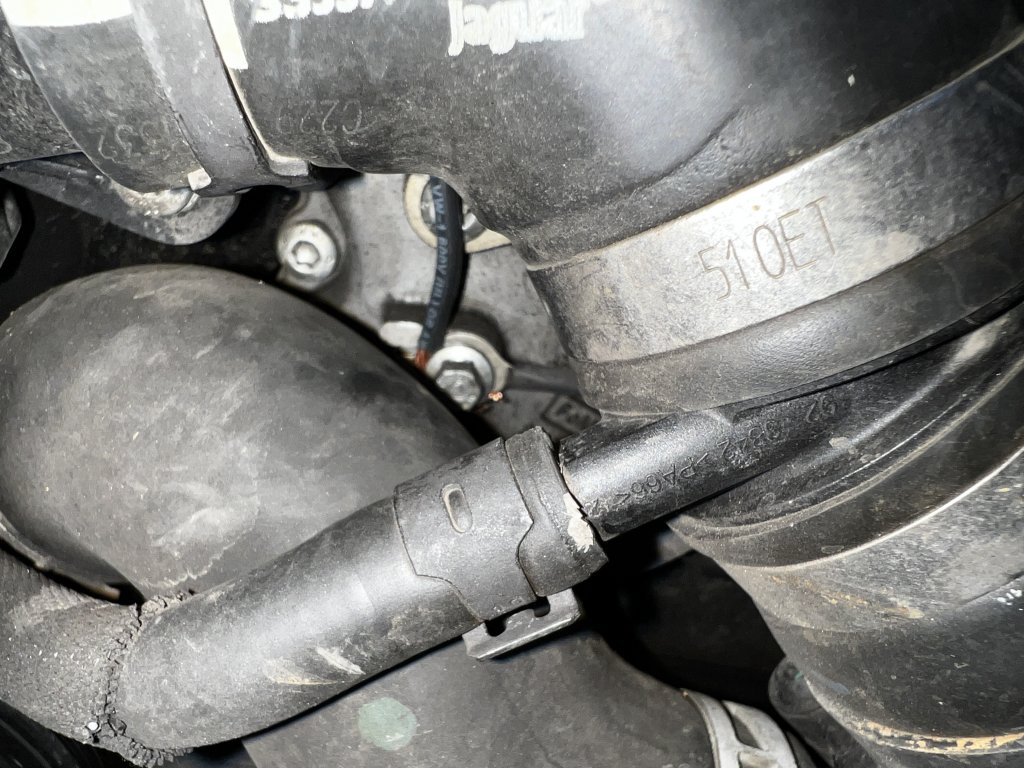

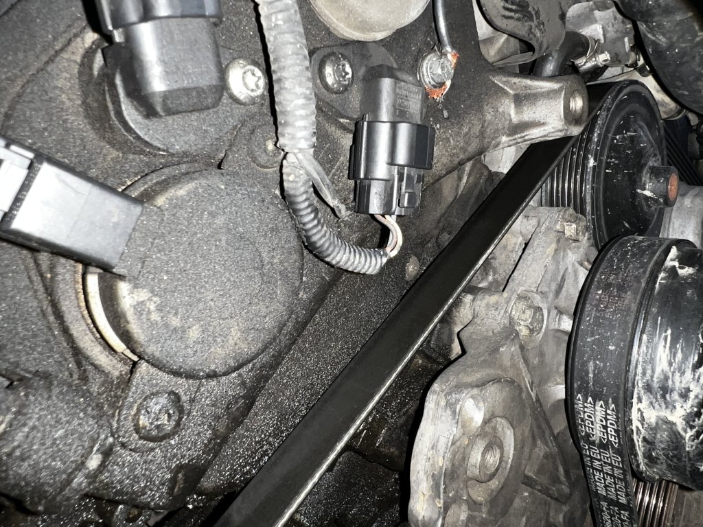

I’ve definitely got some oil on the passenger side. (Ground already removed in photo btw, with the metal showing you can really see how dirty it is
