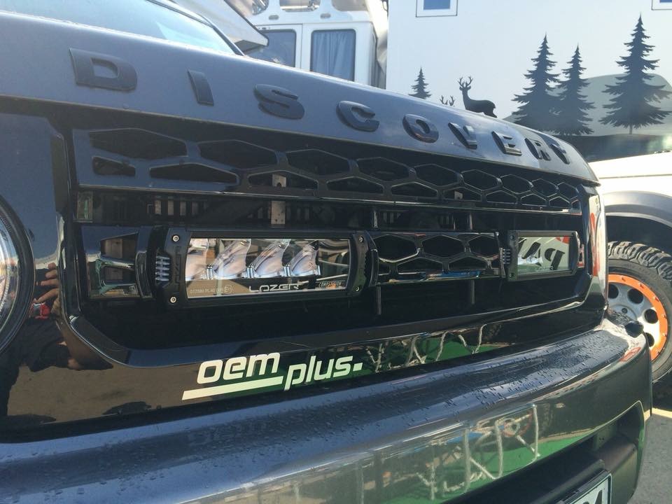

This company makes a solid looking mounting system, OEM Plus. Unfortunately, I’ve yet to find an English site or US Distributed. I’ve sent an email to them. They have it priced at £990 for the mounting system AND Lazer TripleR Elite LED’s.
