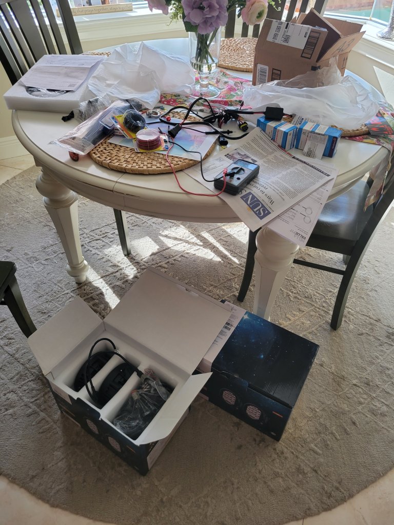

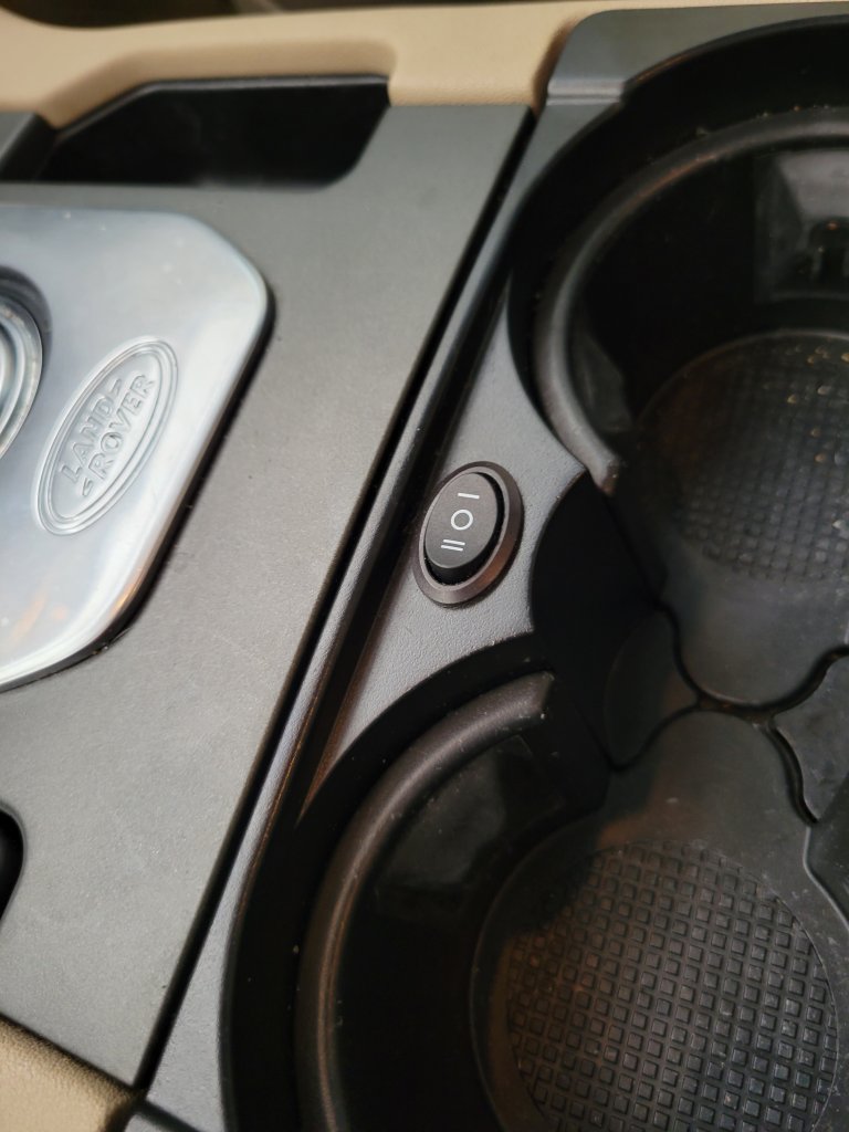

I did some shopping around and made a decision to buy 4 Hella led lights. I also ordered a remote control switch so I could switch them without having to run a taggle up to the. Knowing that I didn't want to run a cables up through the pillar I assumed I would be able to tap into the aft electrical 12 V receptacle.
I've seen some of the builds on this site and they look amazing. I am no jedi, so I called a couple shops and the 2 I got ahold of told me it was A-day's worth of work so I was looking at a $1000 labor. Seems excessive in the dreams of having rough top lights are a wash.
Given that the rear receptacle is rated for a 180 W is it realistic for me to think that I could have a Wire harness made and split for the 4 lights and run up? No need for a relay with the exception of the remote control relay which I could bury back behind the air compressor.

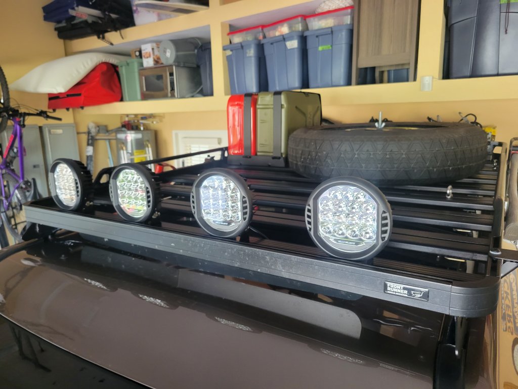

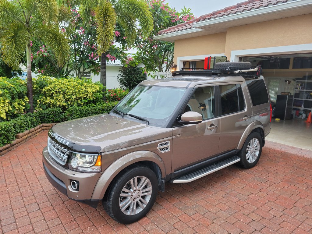

Not the best location but I like how it turned out.
