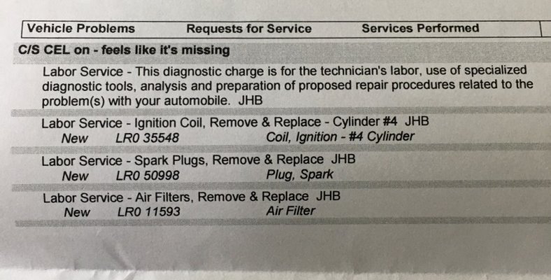

Something that hasn’t been mentioned is the work they did the day before of replacing the plugs and Cyl4 coil. Could this have played a part in overheating? Timing issues?

On the SC model, removing plugs and coils shouldn’t really require disconnecting coolant lines, although the SC coolant lines are maybe a little in the way, so a mechanic might find it easier to disconnect. You could check that invoice to see if they have any charge for coolant.

Here is the work done the day prior to the incident. Doesn’t say anything about coolant, and nothing was discussed in regards to that.
In the few seconds from the overheating warning to shut down, there were no other warning lights that came up. The engine had some stumbling and I guess you could call it clicking/knocking right before it shut off.
