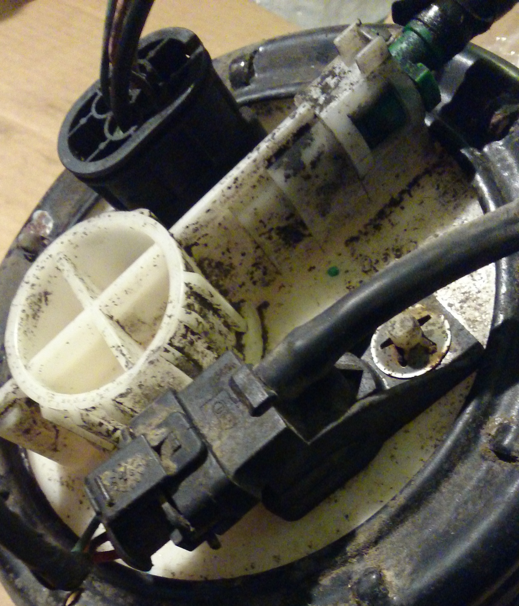

Hello Good People,
This site looks awesome!
I have been reading the threads for awhile now and need some help.
Still in the process of tracking down a no start on the 1999 D2.
I have been reading the threads for a week now and would like exact instructions on what wires to jump on the fuel pump to see if it is defective or not.
I have a red wire with a 15amp inline fuse, along with a black wire ready to go.
As of now all onboard fuses are working.
The CPS was replaced over the weekend.
Switched washer and pump relay, still no start.
The inertia switch?
I jumped the two outer pins together, leaving the inner pin untouched.
Is this correct
The fuel pump relay?
Do you jump pin 30 and 87?
She turns over just fine but no start...
Starter fluid gets her going every time but dies when it dries up.
T.I.A.

Welcome to the forum... Easy test for fuel pump... Relay is in passenger foot well. Have someone listen when you turn the key and listen for it to click. If it clicks relay is good. Now have them listen to the fuel pump by having them in the back of the Rover or under the rear by the tank. Turn the key if they don't hear the pump it is probably bad (check for voltage going to the pump. If you get voltage but no pump it is bad. If no voltage check the wiring going near the drivers side rear fender well there is another plug there. If all is good then try a simple light bulb test by disconnecting things and appling power to the wire and see if it can light up a bulb at the wires at the fuel pump... with everything disconnected of course.

Thanks for the feedback. In the end it was the aged old original fuel pump that went out.

Hopefully you will only have to change it once... don't let the tank get below a 1/4 tank and it should keep the pump cool and happy.
