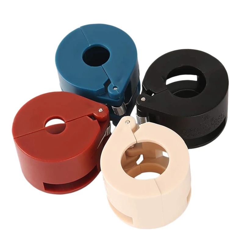

Is a special tool needed to disconnect the fuel line from the fuel rail on a 4.4L LR3? What is the process of disconnecting the fuel line/rails? Any guidance would be appreciated.
Rover Range
Jun 13, 2022
562
308
Texas
With this tool. The blue one. Found at any auto parts store.
