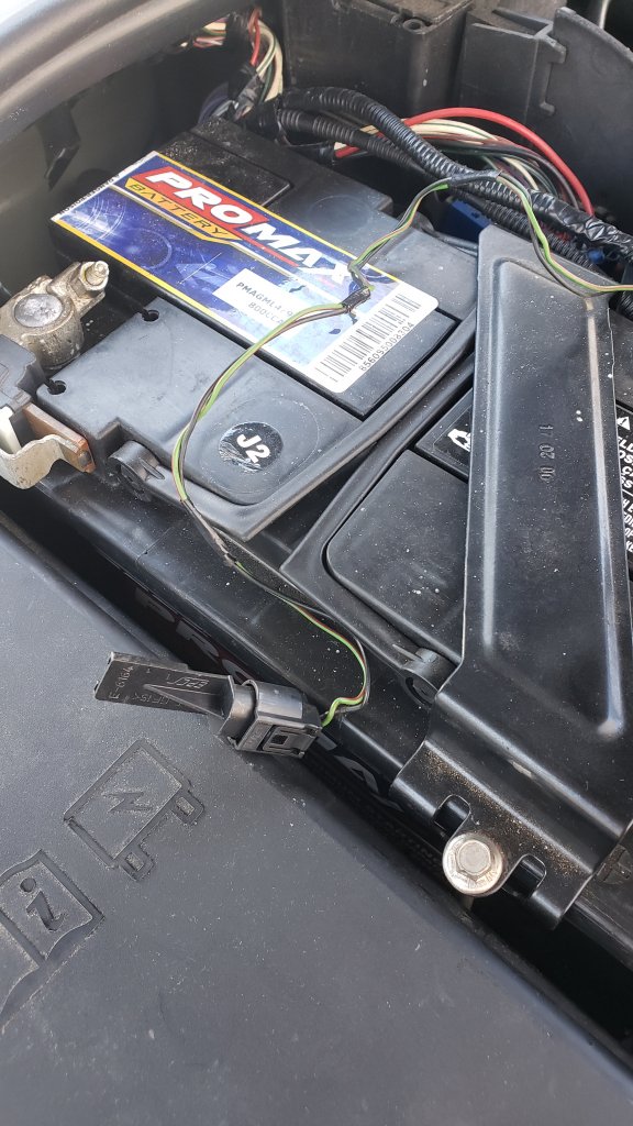

My battery recently died and I'm getting a new one. While taking a look at the battery, I noticed this wire or fuse laying on top of the battery not connected to anything, attached is a picture. Does anyone know what this is for and what to do with it after I replace the battery? Thanks.

The early models had a transit relay that would cut power to the vehicle during shipping.
Land Rover quit using the relays, so they capped off the connector.

That's the connection to the shipping/transit relay, used only during shipping from the factory to the dealership.
Make sure the cap is on clicked on properly and is tight and tuck it away safely.
