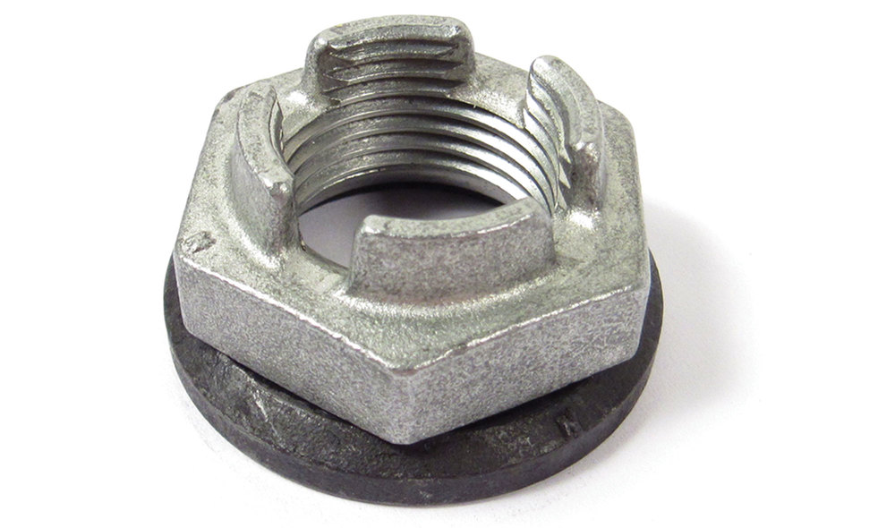

Alright so my hub assemblies come in tomorrow. I notified that my axle nuts are the new design (36 mm, castle nut with integrated washer) and require no staking.
Here’s what they look like. I drove over to the new dealership and bought 2 new nuts.
Not 100% sure if these are reusable or not.
I also had them check the torque spec for me. Topix shows 169 ft lbs which is considerably lower than the old design which required staking.
Anyone have any experience with these types of axle nuts? Thanks.

FWIW, I would think that is likely reusable unless it was damaged by a bearing failure and no longer has a flat surface to mate with the bearing.

Kind of what I'm figuring. I bought new ones so I'm going to use them anyways.

Normally the castle nut would use a cotter pin to prevent loosening of the axle nut. Hence, no staking required. But, I don't remember our axles having a hole to insert a cotter pin into. I'm sure it's fine. Someone much smarter than me designed it
