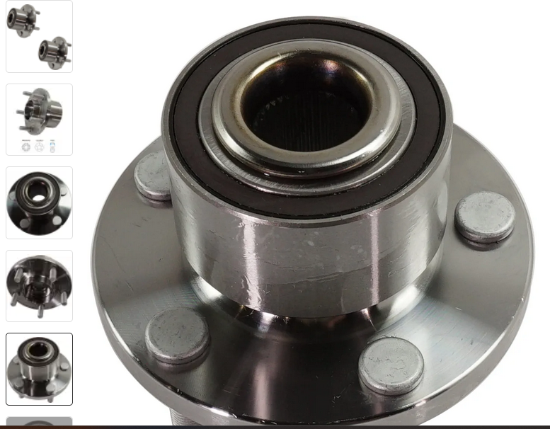

I am one of the unfortunate souls that bought a 2009 LR2. Its time for a new drivers side front wheel bearing. Before bugging the collective brain-trust here I did my research via the YouTube so lets get that out of the way.
?? I see my replacement parts do NOT attach via the for bolts on the receiver side of the new assembly. It appears that the new round cylinder is pressed into the front end wheel/steering assembly. Am I correct?
It sure sounds like this a job for shop and a stretch for a shade-Tree mechanic.
Am I right on both accounts?

The bearing is pressed in.
It is a fairly involved job to replace the bearing. You will need the necessary adapters and a hydraulic press.
