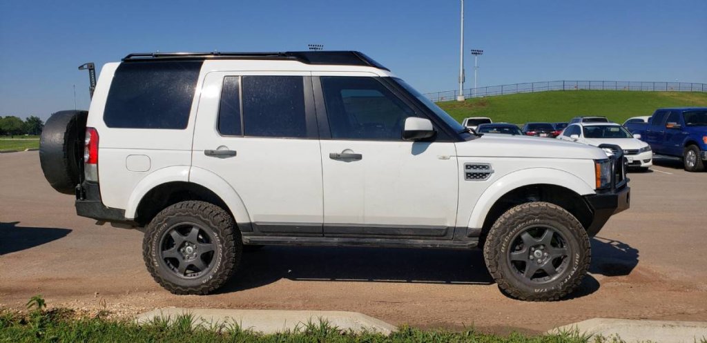

Here is mine from several years ago crawling up "the wall" at Poughkeepsie gulch. Pardon my buddy's gooberish commentary.

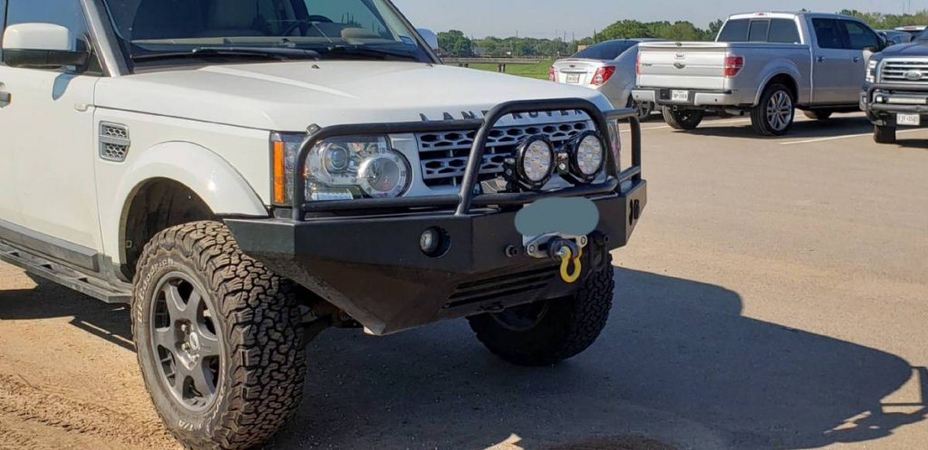

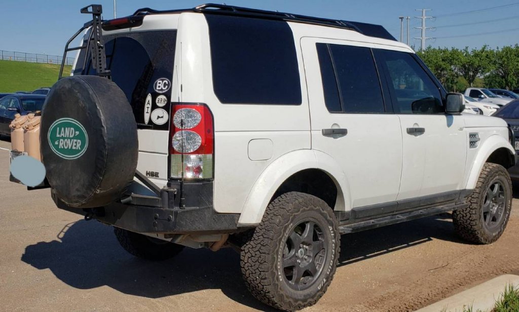

As she sits now...
Second pic of your rig, looks like you have a plate of some sort where the factory spare goes.... Or am I just looking at it incorrectly?
