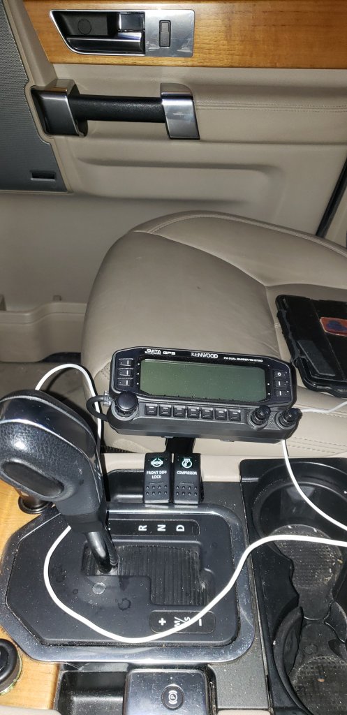

Radio under driver's seat.
Mic clip on front plastic trim panel of drivers seat.
Antenna on TR rear bumper.
Wired directly to auxiliary battery.

Ah! Split mount....guess it might be time for an upgrade of my old kenwood. Is yours the TM-D710GA? Love the "baked in" APRS. It has been so long since I have shopped for a new radio, I don't really even know what is available.

Yes, it is the 710GA.
I picked it for the pretty much plug n play crosslink repeat with my handheld Kenwood.
For those that don't speak HAM, that allows you to park the vehicle with it's nice long antenna somewhere and then use that radio as a repeater for your handheld. If for example, you decide to hike off into a valley where cell/radio signal is non-existent you can still maintain comms by routing your handheld's signal through the radio in the truck that is parked in a nice high spot where it can hit a repeater.

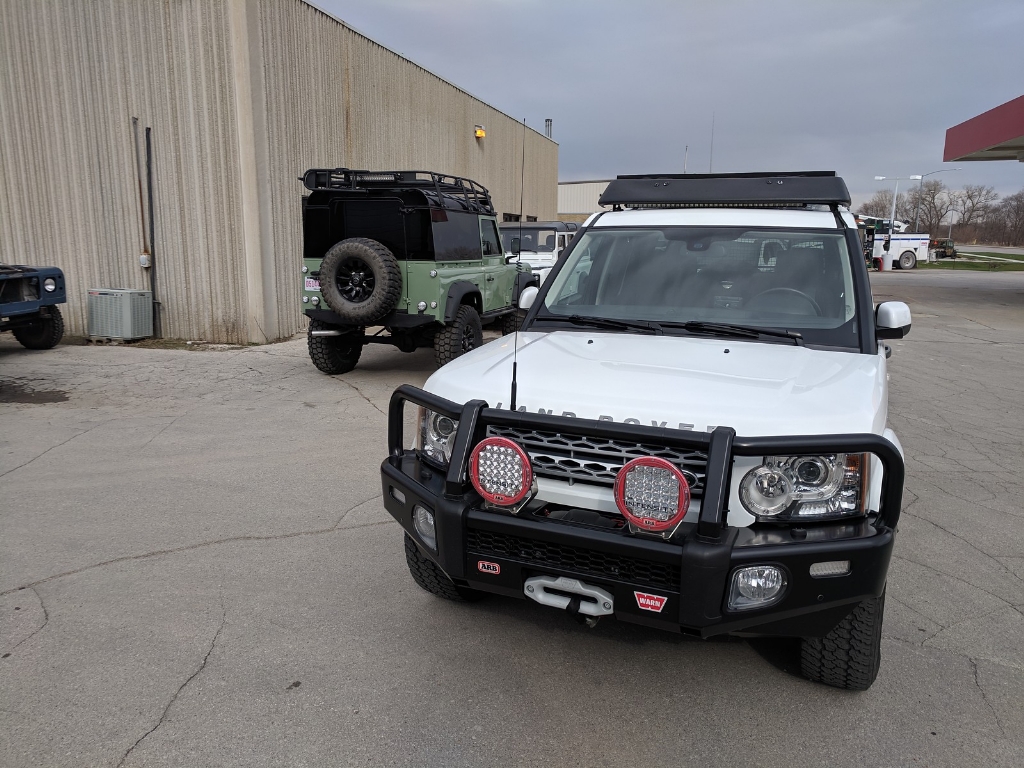

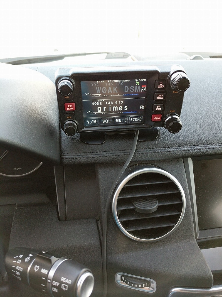

I just stuck my FTM400 on the dash with the included sticky mount.. hope it doesn't damage it if I ever move it. I put the mic mount down on the center console near my right knee. 40" VHF/UHF ant is mounted on my ARB bull bar. Perfect fit.

every time I see that arb on your truck I like it more and more. Truth is, I have never been a big ARB fan....had one on my FJ80 and didn't really care for it but seeing this on your Rover has me changing my mind in a hurry.
