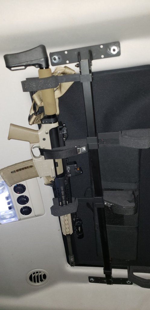

Would love to see pics of this bad boy. This will also be my elk hunting rig. How was the install?
Piece of cake to install. Two screws to remove each grab handle, replace with rack and secure with screws. You could reinstall the handles over the rack plates if you used longer screws, but I chose not too.
It hold 2 long guns, and my solar panel rides on top of it as well.
That is my little 4.5 pound "survival" AR. It is virtually always in the Rover. With the way the roof line works and tinted windows, it is virtually impossible to see even through the untinted windshield.

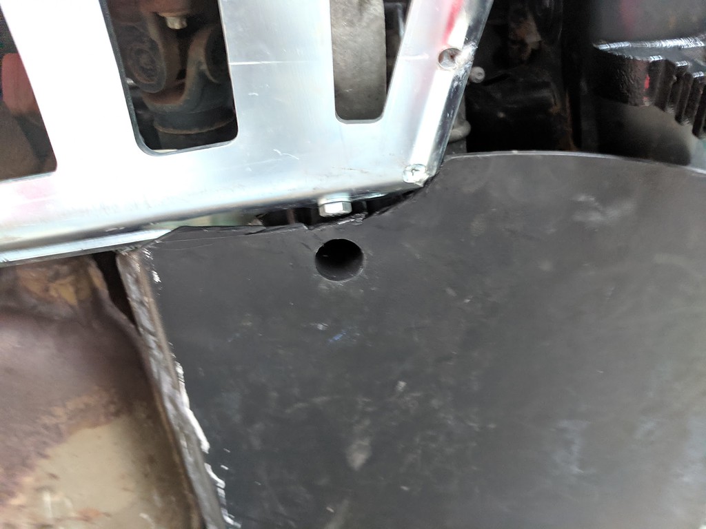

Gives it strength along the long axis and makes it drain better. Same with the other side sliders, he put in drain holes in the compressor bump. I also had all of my stuff spray metalized (like galvanizing) So that even if the powder coat is scraped off they won't rust that easily.
I need to go back and clean it up more, I cut it while it was mounted... but I just cut some off the back of the gas skid and it seemed fine. I'd like a little more clearance actually.. and I want to make sure I have a good thick coat of protection now that I cut off the galvanized protection along that edge. I used a 1/4" longer bolt for the skid. The gas skid actually is still a little higher and meets up nicely with the diff skid. Doesn't look awkward or wrong even though the gas skid is 1/4" lower right there.
Oh buddy....you just saved me some time. I already have the asfir rear diff guard and almost put an order in for the TR gas skid (he's sending me a quote now)...I am going to see if Eric can mod it for me before it ships. Good call @mbw
