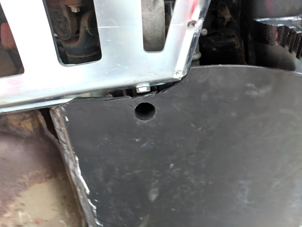

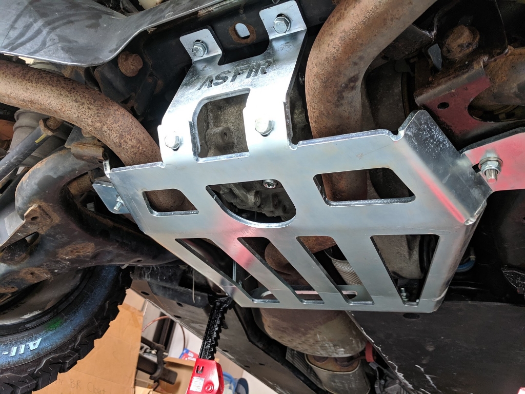

Also, as far as skids.. The Tactical 4x4 stuff is super stought... probably overkill.. but great for sliders, gas tank skid and transfer case. I just put the ASFIR rear diff (And exhaust pipe) guard on and I like it. Good fitment (although I did have to cut the T44 gas tank skid a bit because it shares a bolt with the asfir). Its pretty light weight also. I kinda wish all my skids were that light.
Those damn exhaust pipes stick down below the suspension arms in the rear...

The Tactical Rovers gear is literally bomb-proof, but heavy as hell. If I were starting from scratch, I would look very hard at the ProSpeed aluminum plates just for the weight savings.
My Asfir diff plate also required some surgery for the same reason.
I have laid under my truck for an hour or so looking for a different routing for those damned exhaust pipes. If you come up with an idea in a moment of clarity, by all means, please post it up.

The T44 transfer case skid does cover the transmission, it just protrudes back past the cross member and also protects the transfer case.
It goes from the factory skid all the way back past the transfer case.
I can get better photos if you need, just let me know.
Interesting.
My TR fuel tank plate doesn't have the vents that yours does. Must have been a design change at some point.

Gives it strength along the long axis and makes it drain better. Same with the other side sliders, he put in drain holes in the compressor bump. I also had all of my stuff spray metalized (like galvanizing) So that even if the powder coat is scraped off they won't rust that easily.
I need to go back and clean it up more, I cut it while it was mounted... but I just cut some off the back of the gas skid and it seemed fine. I'd like a little more clearance actually.. and I want to make sure I have a good thick coat of protection now that I cut off the galvanized protection along that edge. I used a 1/4" longer bolt for the skid. The gas skid actually is still a little higher and meets up nicely with the diff skid. Doesn't look awkward or wrong even though the gas skid is 1/4" lower right there.
