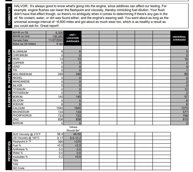

Attached is my first Oil Analysis, 130K on my motor, This is the first time I have used the OW-20 SpecialTec LR Liqui Moly. Prior to this oil change I used their Motor Oil Flush and then I used their Ceratec, and Motor Oil Saver products along with their Specialtec 0W-20 LR blend.
EDIT: Forgot to say I have a 2011 with the 5.0L v8

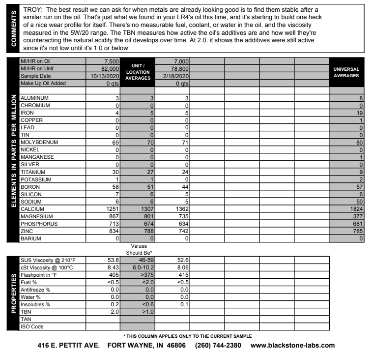

I will add mine. 2013 LR4 at 82K miles. I love how flowery the comments are from the Blackstone team. I'm expecting the next one will say "good job, your oil has a great social life and is fun to hang out with!". :)
If anybody is interested, I could start a group shared Google doc and we could put all our data in there to see how it looks over a number of vehicles and model years...

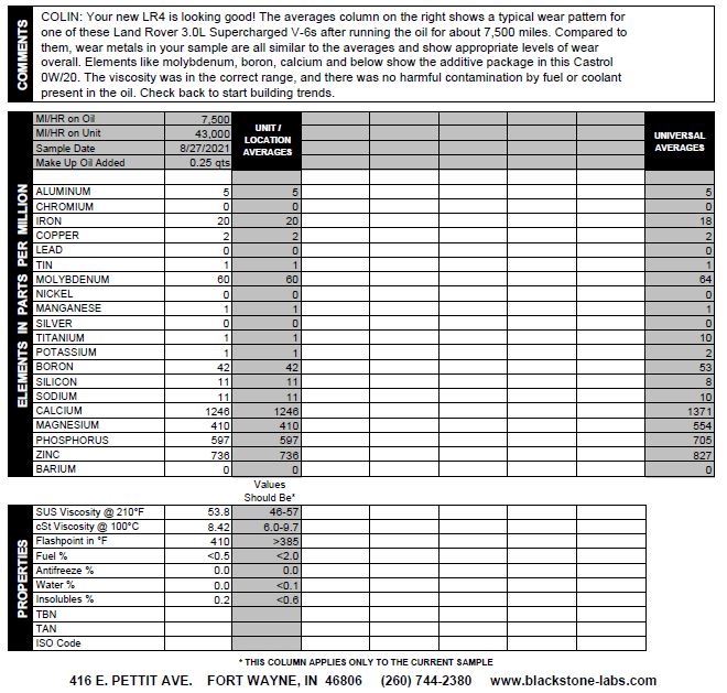

2016 LR4 at 43K miles. First oil change since I've bought it, did it in my garage with help from the oil change thread here. The JLR shop I bought it from said the oil was changed when I bought it, so I'm assuming it was the JLR spec castrol. The new oil is the extended performance edge0W-20 (i.e. the gold bottle) since it was on sale at walmart and they didn't have the mobil 1 in stock. I plan on keeping the 6000-7000 mile OCI going forward

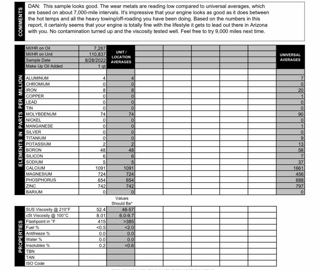

Here’s another sample from my 2013 MY. I’ve been running Mobil 1 5W-20 EP since I got the vehicle at 40,000 miles.
