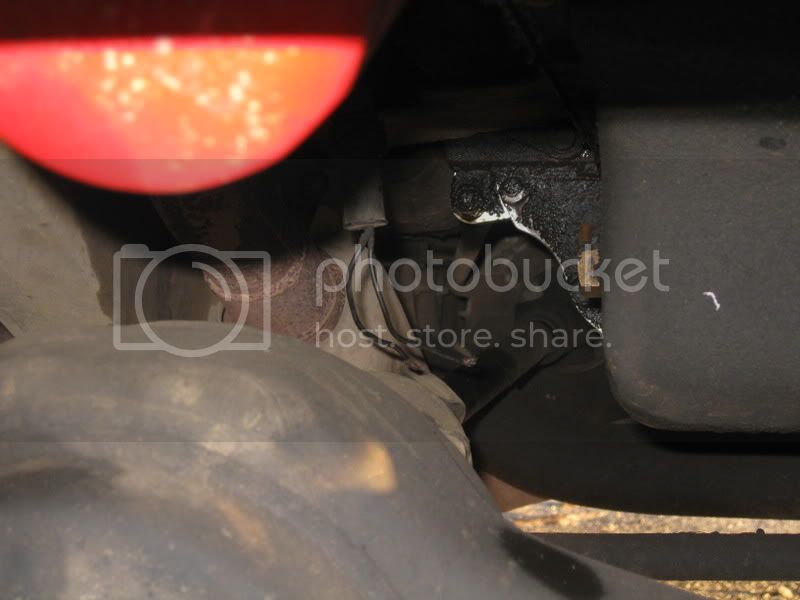

So I just took a peek around my car and found that there was a pair of wires dangling from an electric connector...but seemed to have been disconnected from the actual sensor (the wires were soldered on). I don't quite know what this sensor is, but it is a bolt type sensor that screws into the left side (looking to the front of the vehicle) of the oil pan. Oil temp sender? Nathan said it might be a crankshaft position sensor, but I don't think we we're on the same page.
Pics are worth a 1000 words....

this is right above the font differential and left of the oil pan
