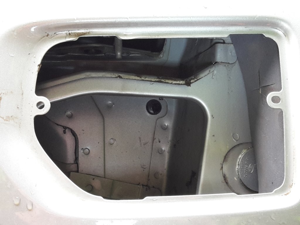

Mine lives outside and I clear the drains a couple of times a year, amazing how much gunk collects at the top and bottom. If you pop out the side vents you will see a bit of triangular foam in a plastic bag wedged in a stiffener / strengthening panel that is probably added to deal with some noise transmission. I've removed these as on one side the sunroof drain comes out directly behind it and if the well paid worker who shoves these in wasn't on this best game it could block / restrict the drain. I haven't noticed any difference in cabin noise with these removed. My tip to remove the side vents is to grab a light and a long thinish ***** driver and coming from the hood hinge opening you can put some downward pressure on the tabs that keep the vent grills in place and pull on the grill while doing this. You can try the grab lift and pull but its ******* the fingers.

I wondered about the bag of foam stuffed down into that cavity. If you say you don't notice much noise difference, the next time I'm in there I may take it out. I could see it blocking the drain. I don't believe there is much difference between the driver side vs the passenger side front drains from the sun roof. I had a blocked front driver side drain. What I did, was to drop the headliner down a bit so I could get my hand up in there and I pulled off the drain tube. With my compressor I blew air down the line until it blew the crud out. Been fine since.

The foam is to block off water from getting into your air intake which is on the side to the right. Keep the foam in there. It’s made there for a reason and a big reason it is. Who cares about noise reduction, it could cause a much bigger problem than that. Hope that makes a little more sense. And you can move the sunroof drain hose and point it down a little more. But just make sure that black ****** is through the hole, and make sure it’s still in good condition and not all gummed up, because it will get sticky and gummy over time.
