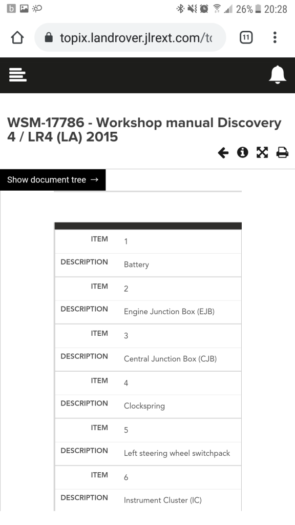

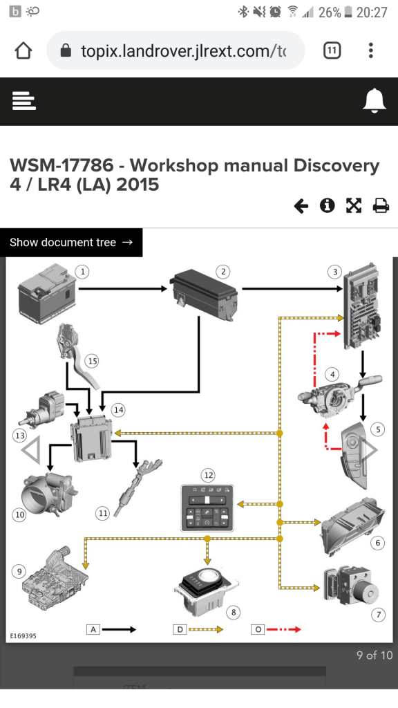

Hope these help. The black is hardwired, yellow is high speed canbus, and red is LIN.
  • 1070127 (1).pdf
  • EJLR 03 26 21_2E - DISCOVERY 4 - LR4 iEWD (LHD) (2a) _ TOPIx.pdf

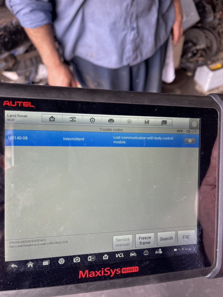

Update. Cleared all codes. This is the only one that popped after driving it and attempting to use the cruise control to no avail. 56B9EEA1-5F25-447E-8993-4657D7AEDC7B.jpeg
