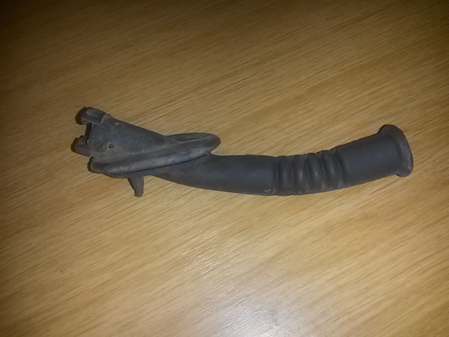

How do I replace the drain pipe
I wish I got hold of this forum before I pulled out the whole rubber pipe. (see attached photo)
My problem is two fold. I had water dripping on the transmission switch causing it to give an error. I removed the pipe on the passenger side (R/H Drive) because of this. Then the carpets started to get soaked on passenger side. Haven't rained in a while in Cape Town.
How do I refit this pipe and how do I stop it from dripping on the switch again.

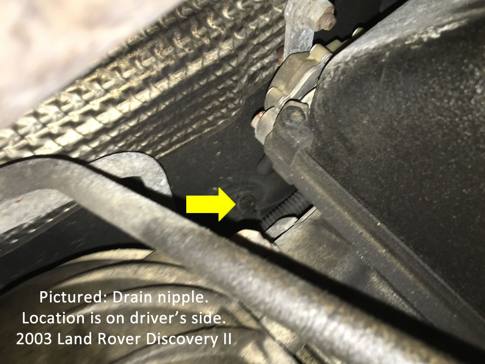

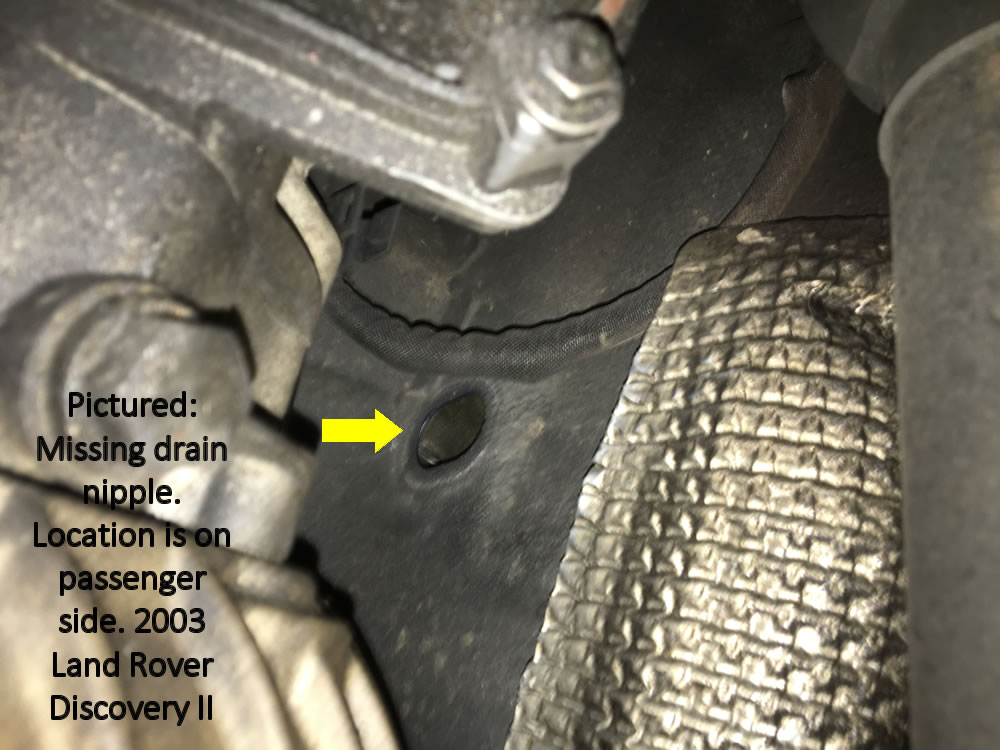

Hey [email protected],
I am currently working through the same issues on my '03 Disco II. My car acumen is quite low, but hopefully it's not the blind leading the blind.
I have also attached two photos that I think may help. Please note, the passenger side drain ****** is missing on my Disco, but the driver's side is in place.
Side note: If anyone has suggestions about missing drain *******, I'd greatly appreciate some guidance!
1. When crawling underneath, consider where you think the center console is in relation to where you are looking.
2. I've heard other descriptions, but try to locate the "front-end" of the transmission is.
3. When you've found this spot, you will see openings on either side. Your drain ******* are located in this area.
Be sure to confirm that the Disco I has two drain ******* though (For some reason, I think I read that there is only one).
