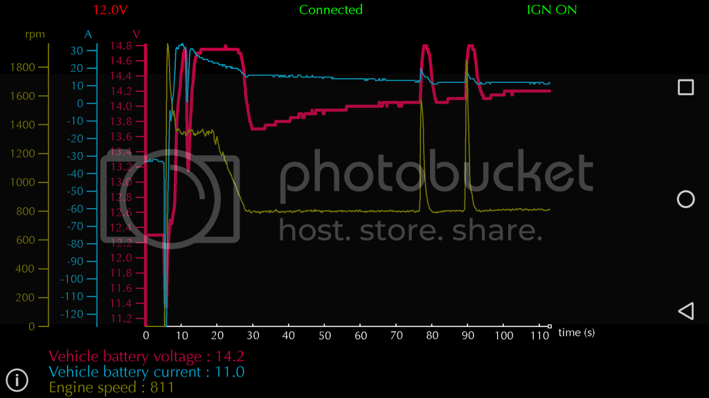

Do you have an IID tool? I'd be curious what your computer is currently using as a charge profile. (I ended up doing a little research into this as I think I had a bad alternator, but am not exactly sure because the computer does... things)

I do have one, I can't find this charge profile anywhere. What menus do you use to get there?

Create a chart with the fields shown in my picture. Live values screen.

I will poke around the live values screen again and see if I can find this data.
