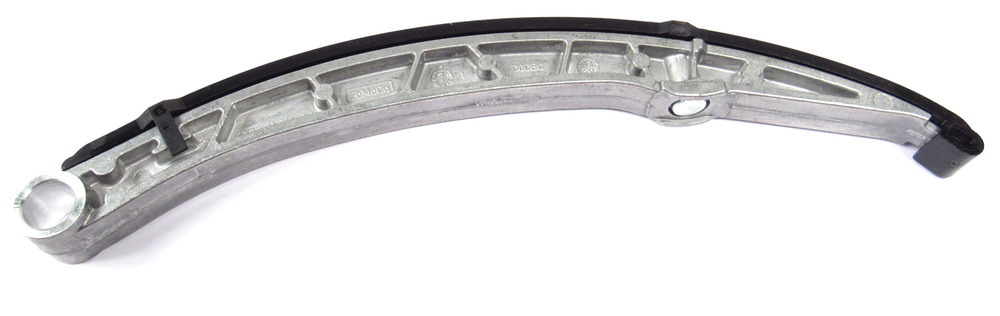

If the job was supposedly done just a few years ago, look to see if the timing chain guides are the updated part. It's been around since it was used in the LR4 starting in 2013. New part looks like this:
With the wear point now having a steel button (bottom of the guide in the above photo, 1/4 from the right). The original guides did not have that.

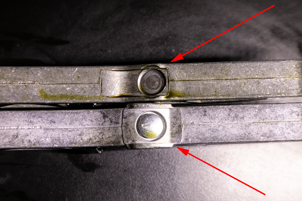

In this photo, you can see where the tensioners have worn into the old guides (top) with the new guides (bottom) having the steel button in the same location.
It's possible the other dealer replaced your old guides with the old part, but that would be dumb, and I doubt any replaced guide would be worn that far within a few years.

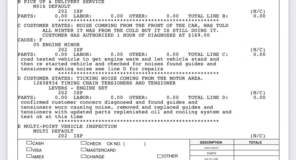

If the repair was done under warranty, you can't sue for fraud.
Get the Repair Order, all the parts used will be listed. Whether or not they got installed, is another story.

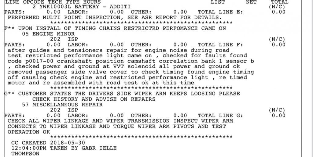

Here is what was documented under warranty

Based on that repair order, I can't tell if the actual chain were replaced, or just the guides/tensioners.
If the chains were not replaced, one possibility is that the chain itself has "stretched" -- of course, the chain doesn't really stretch, but wear at the link pins results in a situation where the distance between, say link #1 and link #20 is longer, which could potentially result in the engine going out of time.
Very true! It doesn't say that. I have some old emails with the service department that I need to go through, and I'm almost certain they did, but it doesn't say it on there!
