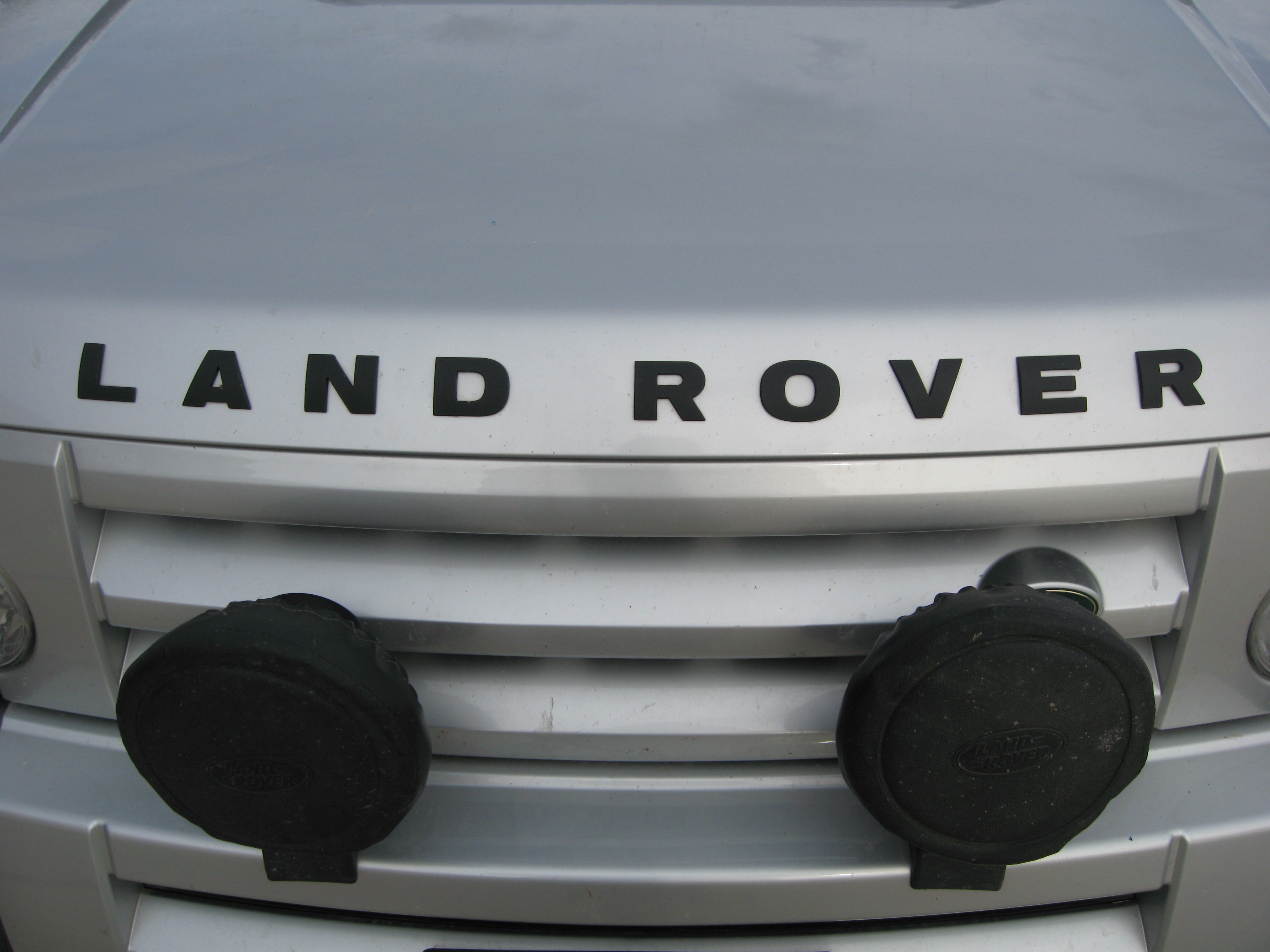

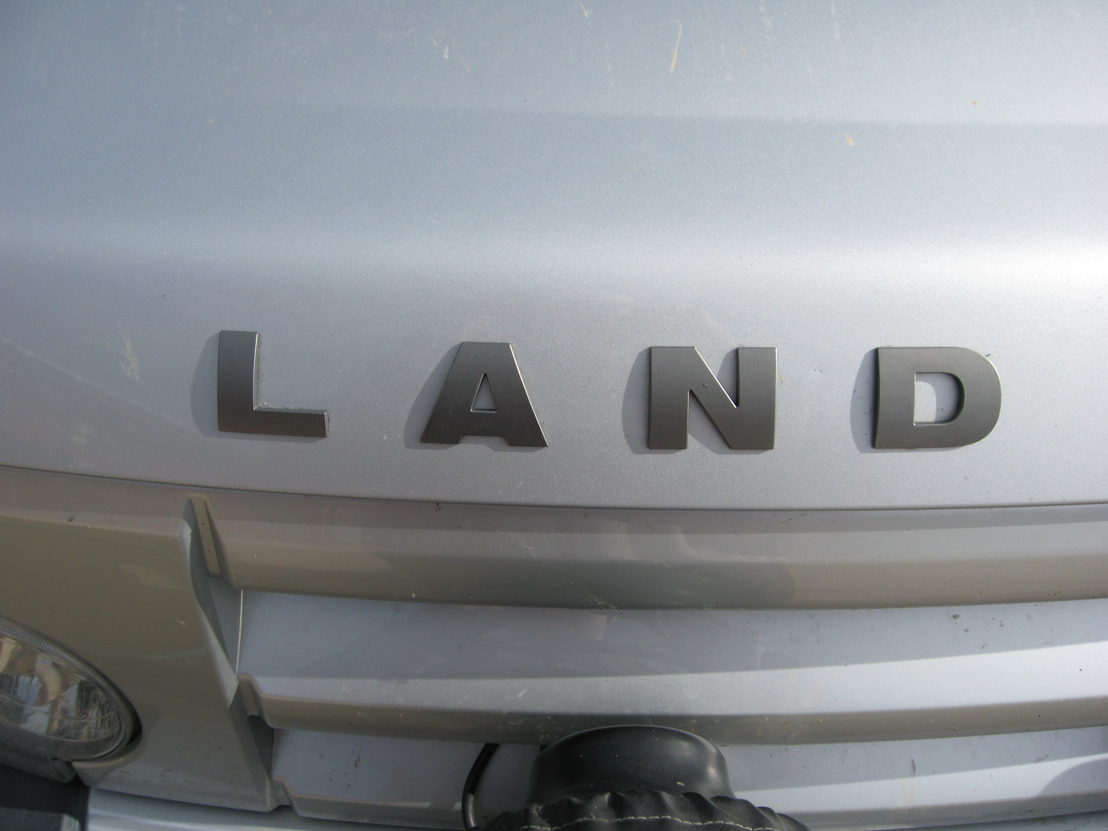

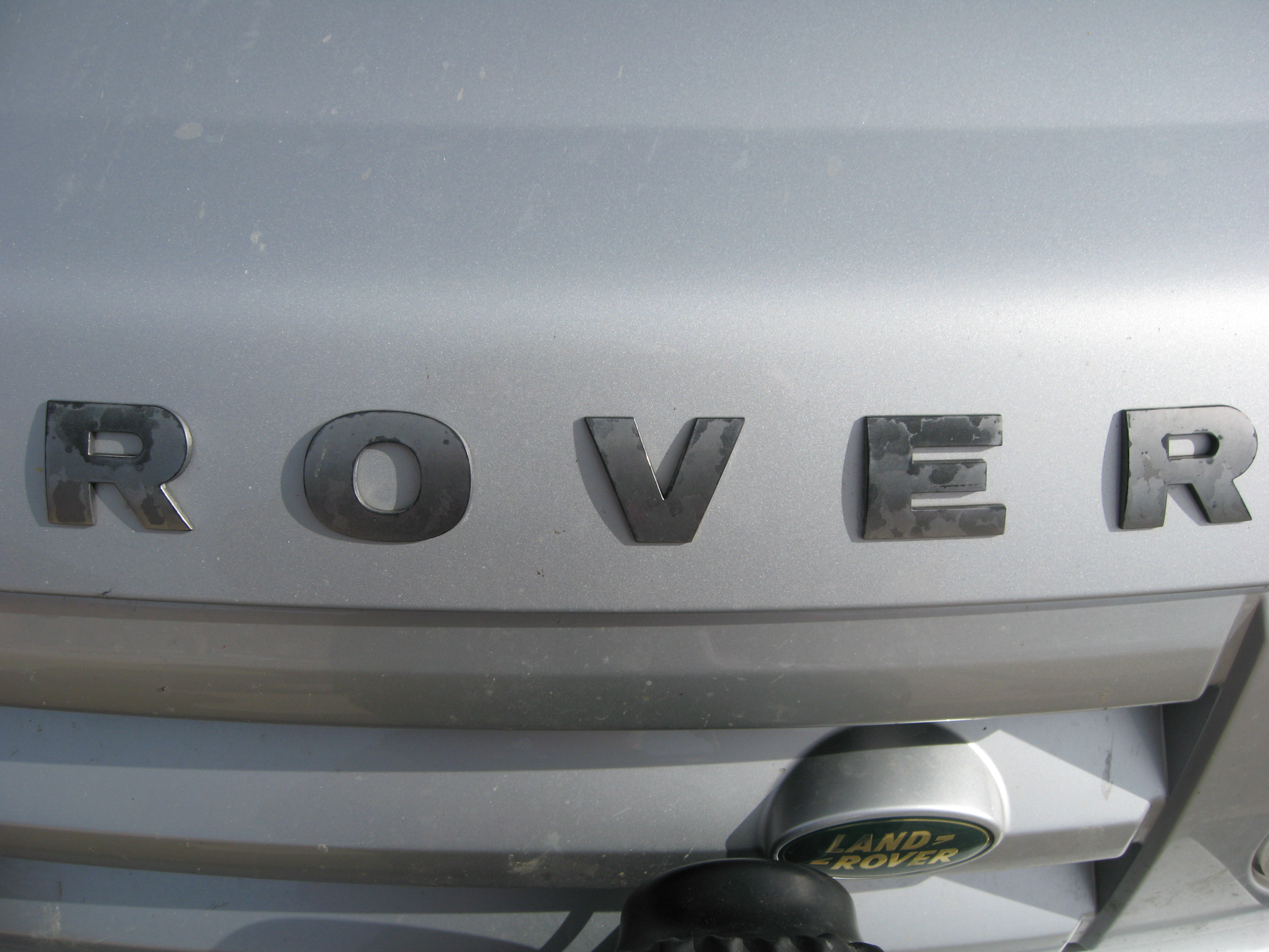

I also repainted the letters on my hood flat black and thought I would show it off. Haven't done the back yet.
escociabhoy
Aug 10, 2011
20
What kind of paint did you use on the letters, did you sand them down first? I'm pretty interested in doing this myself as mine appear to be in a pretty similar condition as yours were before the repaint.
LR3ISFORME
Jul 19, 2012
I just made sure to wash/dry them real good before I painted. Although in my opinion I would get the clear coating off first. If that is peeling away then it wont make for a very clean coat of paint and it could start to peel easier. You can't tell so much from the pictures because of the lighting, but mine had already worn off for the most part and the wash and dry took the rest off.
As for paint I just went the cheaper route and used flat black Krylon spray paint and made sure to apply it in multiple thin coats. Although that is a personal preference because I like the look of flat black spray paint. I would not go with cheap stuff though, make sure you get a good spray paint if you want to go that route.
